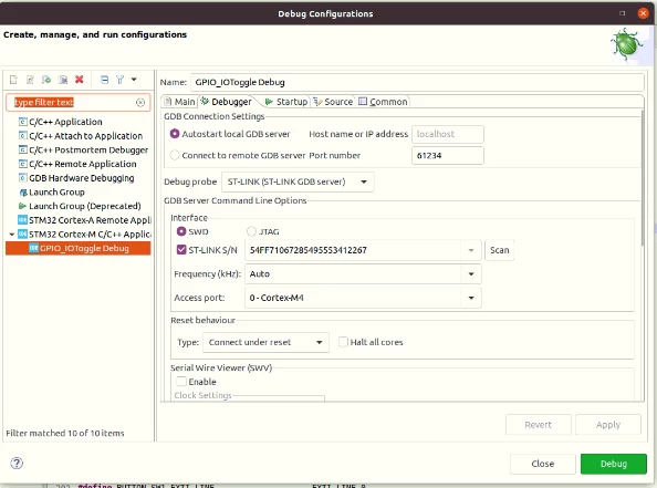

ChahinezC
February 8, 2021
Hello @SPate.4​​,
I recommend you checking the "debugger" section in the "Debug Configuration", you can use the “Scan�? option to detect the ST-Link on your board.
The STM32CubeIDE user guide and the STM32 microcontroller debug toolbox application note can help you solve your issue, you can check the 3.3 of UM2609 and 4.2.4 of AN4989 sections.

Hello all ..
I just started using STMCubeID with my Lora-E5 Development kit board and I picked a GPIO_IOToggle example from the SDK to run. I have already connected the STLink and I was also able to get it scanned in the debugger configuration (Run -> Debugger Configuration), as shown below:
The "Build (Ctrl+B)" is successful. But when I try to run it (Run -> Run), I am getting the below logs, indicating the error "stlinkserver already running, exit" .. Below are the logs:
