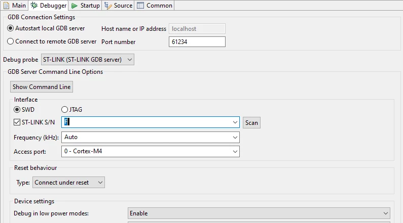

Three of my programmers ST-LINL V2 don't work in STM32CubeIDE! Everything used to be great, I was flashing my boards, doing debugging, but now some nonsense is happening (version of my IDE is 1.8.0). For debugging, I use the interface SWD, and the connection is exactly the same as before. But the most interesting thing is that the program does not see the serial number of the programmer, although everything was fine before. Now I will attach some screenshots.
0693W00000KakDwQAJ.png0693W00000KakB9QAJ.pngAs you can see, the program considers that my programmer (all three!) have a serial number - F. I absolutely do not understand how this is possible. Programmer firmware update did not work. Fun fact: when the program enters the DFU mode when working with the firmware utility, it sees its correct serial number, but I do not know how to get this number to be displayed in Cube IDE.

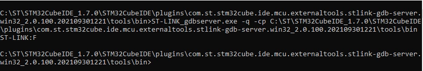

1. In the drop-down list you are talking about, in addition to the number of the working programmer (I borrowed an isolated programmer from a friend, and it works correctly), there is also a "number" F, but it only appears when I connect a faulty device.
2. I tried to execute the commands you indicated on the command line (however, my paths are slightly different from those you gave), and I got the results that you can see in the screenshot. I can say that it did not bring success.
0693W00000Kb6m5QAB.png3. I connected a non-working programmer to the board, performed a debug attempt, and then created a log using the command you specified. I'm attaching the log to my answer.

In the debug configuration of CubeIDE is "Shared ST-LINK" enabled or disabled?
  • When enabled the ST-LINK serial number is provided: ST-LINK server > ST-LINK GDB-server > CubeIDE.
  • When disabled the ST-LINK serial number is provided: ST-LINK GDB-server > CubeIDE.
Two different tools doing the same thing but different implementations.
If the "Shared ST-LINK" is disabled, then enable it to see if this works better? Or try the vice versa.
