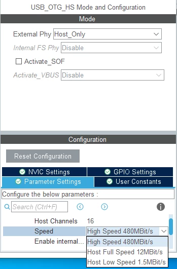

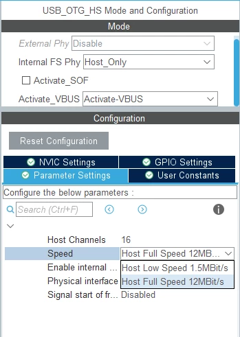

    Infact, the Nucleo board support only the USB OTG FS as mentionned on the DB3171. So, you can only configure the internal FS Phy which support only low speed and full speed (max 12MBits/s):
    But, when using the STM32H723ZGT6 MCU, you can use the External Phy which can go to High speed (480 MBits/s). But you have to connect an external PHY device to the ULPI (which is not done on the nucleo board) as mentionned in the paragraph 3.43 of the DS13313:

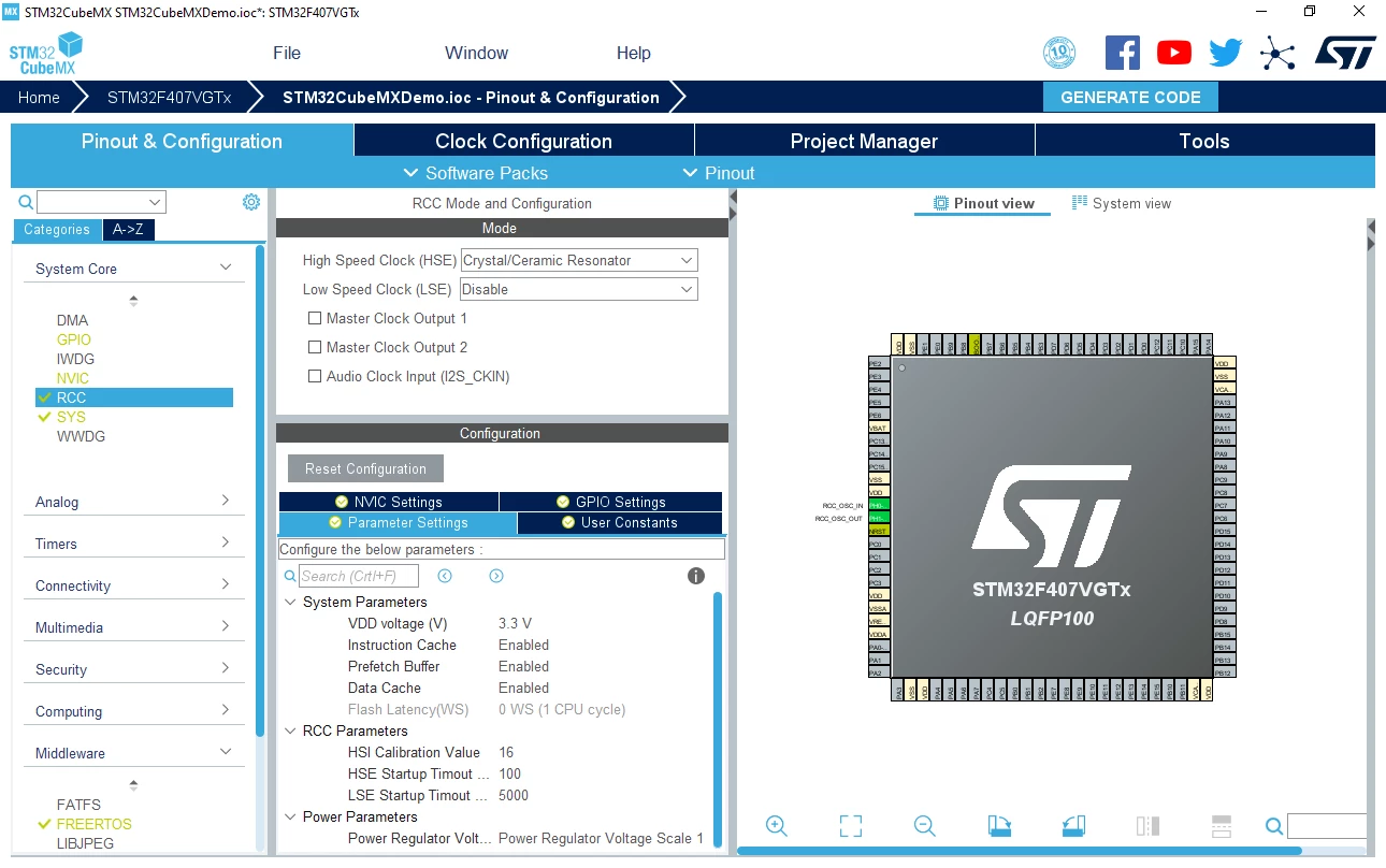

    Have you enabled any middleware on your CubeMX configuration. Enabling the USB OTG/Dual_role does not select any Middleware by default.

    Many thanks for your quick response! No I have not enabled any middleware. I have been using many functionalites such UART, DAC, etc without enabling middleware. this is the first time I see it. How do I enable  middleware?
    BTW I am quite new to this.
    Thanks again.
    STTwo-32
    If you want to use any middleware (lwip for example) you need to configure it using CubeMX middleware menu. On the next picture for example the freeRTOS middleware is enabled:
