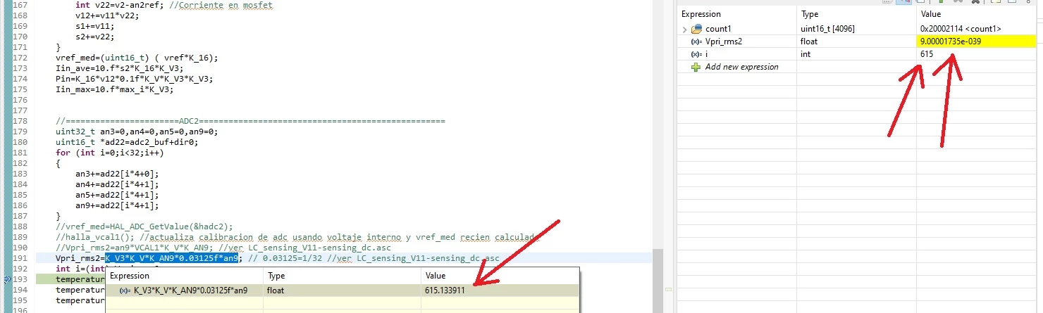

In the debugger, I see float variables as 9e-39 or similar that is totally wrong.
In the following example the correct value is 615.133911
When passing to int it is 615, as expected.
it may be a wrong configuration of the debugger float number format
How can I solve that?

Hola @JLope.11​ , it would make more sense to me the issue is in your code.
That ugly 5 factor multiplication is not doing what you thing should be doing.
Maybe an overflow, underflow who knows.
I would split that multiplication step by step and figure out which factor is messing your operation
your_result=factor1;
your_result*=factor2;
your_result*=factor3;
your_result*=factor4;
Did you already tried changing all variables to double type?

I think the problem is the debugger viewer format.
I have made:
Vpri_rms2=0.9f;
And in the debugger appeared: 9.00002576e-039
But if I make:
double uu=Vpri_rms2;
The value is correct. I think the debugger display try to show double instead of float.
do I have to work with double instead of float or change something in the debugger viewer setup?
JLope.11
JLope.11Author
January 19, 2023
SOLVED: the problem was that I configured ADC+DMA to fill double than assigned buffer, so wrote out of the memory.
Now the debugger works fine.
