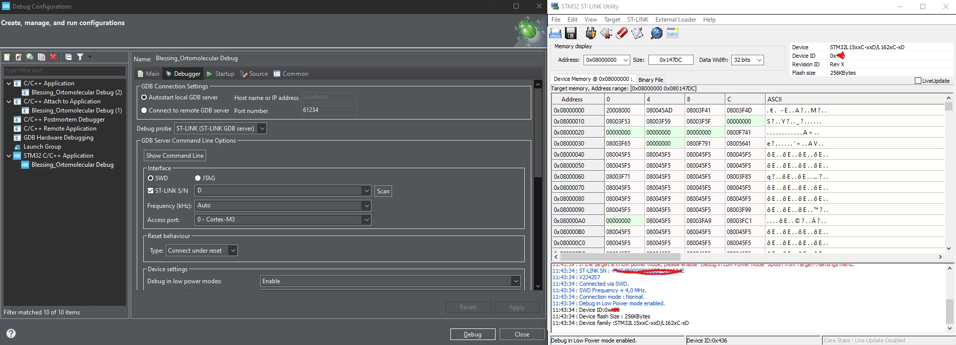

Hello everyone,
I trying debug a project,bu t when I connect Scan my ST-Link in CubeIDE got wrong S/N and error when start.
In ST-Link Utility gets rigth S/N.
Any solve for this case?
I have tried ohter cable, drivers and etc...

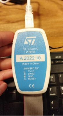

    AScha.3
    AScha.3Best answer
    July 26, 2023
    same problem see:
    https://community.st.com/t5/stm32cubeide-mcu/stm32cubeide-not-finding-st-link/td-p/577346
    SN "D" shows, IDE found no genuine STM chip on stlink programmer, refuses to work.

    MuriloCFAuthor
    July 26, 2023
    Hello @Semer CHERNI,
    Thank you for reply,
    My STM32CubeIDE is version 1.13.0, I'm using a custom board with STM32L151.
    When I debug get this and nothing more
    Tesla DeLorean
    Guru
    July 26, 2023
    Two applications can't have a connection open concurrently.
    A serial number 'D' seems indicative of a clone / pirate ST-LINK.
    ST-LINK Utilities has been deprecated for many years, use STM32 Cube Programmer as a better means of establishing compatibility / usability with STM32 Cube IDE
    MuriloCFAuthor
    July 26, 2023
    Hello @Tesla DeLorean,
    I openned aolne each application, the image i put together just to show.
    and thank you for the tip about Programmmer.

    July 26, 2023
    Probably the "Scan" functionality is not implemented correctly on counterfeit chips. They seem to have serial-number related issues based on the posts that pop up here.
