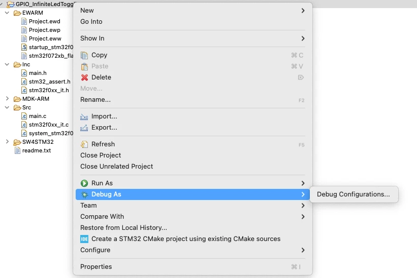

Hi there, I’m a beginner to STM32CubeIDE. I was running examples downloaded from STM32CubeMX for the Nucleo-F072RB on a Mac M3 using STM32CubeIDE. However, I suddenly encountered an issue where I can’t debug anything. The default STM32 debug configuration, which was functioning correctly before, is no longer visible.
I’ve attempted to uninstall and reinstall STM32CubeIDE, but unfortunately, the problem persists. While I can create a debug configuration file, I would greatly appreciate your assistance in restoring my default debug configuration. This would be a significant relief for me.
Because the debug config and other files that belong to specific project are stored inside the project, not with the CubeIDE data.
So you can create a new debug configuration from scratch and it works?
tinu8888Author
Feb 8, 2025 12:35 AM UTC
I can create a debug configuration file, but I’m unable to see my default STM32 debug configuration option.
Pavel A.
Feb 8, 2025 12:43 AM UTC
Sorry, then this is all relief that one can get. Files not backed up can be easily lost :(

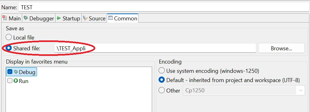

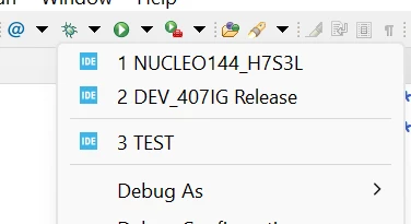

Did you set shared file for your config?  this file can be backuped.
It is also good to set display in favorities.
Check:
workspace .. \.metadata\.plugins\org.eclipse.debug.core\.launches    for any *.lauch files
edit 2.
Your debug config should be visible
Not that as You try on
