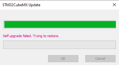

STM32CubeIDE crashes when trying to create a new project
- September 27, 2021
- 1 reply
- 1994 views
every time I try to create a new project by clicking on "Create a new STM32 project" or "Create a new STM32project from an existing STM32CubeMX configuration file" STM32CubeIDE crashes abruptly. After a few tries I caught the error message with a screenshot which is displayed for a fraction of a second right before it quits.
- This is a fresh install of SMT32CubeIDE 1.7.0 on Win10 without any config changes
- I also tried v1.6.1 with the exact same result
- Both revisions were installed in the default installation path
- I first had the workspace set inside my user directory which has a space in its path. Since I read that this may cause problems I have also tried C:\ST\STM32CubeIDE\workspace_1.x.x with the same result
- In workspace\.metadata\.ide.log (attached) I found multiple entries "[FATAL] Updater:294 - Updater called before beeing initialized" which seem similar to the error displayed by the UI
- I disabled automatic updates in the preferences, but this did not change anything either
I found a few questions by other users with somewhat similar problems but no fix for any of them.
Regards, Felix
EDIT: I have added the second logfile .log to the attachments as well.
