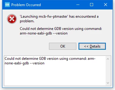

The error happens starting the second debugging session: the first session after starting STM32CUbe IDE is always successful.
This is the error window:
gdb error windowgdb error window

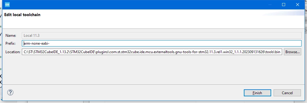

I tried forcing the path for the tools, the problem persists:

I am still having this problem off and on. The only insight I have into it is that I think it might be because of the security software that we run on our PC's as well blocking the call to the command prompt when the gdb server is launching. I disabled our security software which made the gdb_server work again. I'd look into that angle if you haven't already.
Adriano Melis
Sep 27, 2024 9:41 AM UTC
Thanks. The problem has been solved here by the ICT guys in my company, the security software now does not intrude anymore during STM32CubeIde and related processes running. The result is that building/compiling is again very fast and debugging is working well again.
Explorer II
Jan 27, 2025 9:45 PM UTC
I found that my network timeserver was unreachable (a reboot had caused it to switch from a LAN port to a WAN port). Resynching time solved the problem.  Based on all the similar complaints I've seen regarding the "Could not determine GDB version usin..." issue I've seen here and elsewhere, I'm curious if others have seen a similar fix.  I only found my server was down when I tried starting an Arduino 2 app which hung on startup.  A community note there found that Arduino also does a time check at startup.
