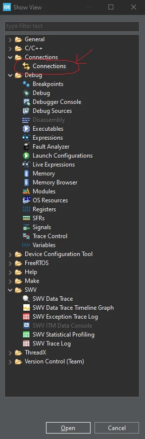

When selecting the connections view in STM32CubeIDE (latest version):

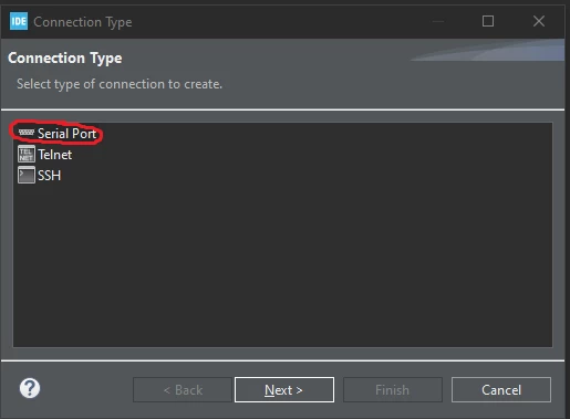

_legacyfs_online_stmicro_images_0693W00000bjX1PQAU.pngThen adding a serial port:
_legacyfs_online_stmicro_images_0693W00000bjX1UQAU.pngThen connecting to a UART connection on any of the Nucleo devices:

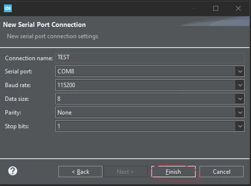

_legacyfs_online_stmicro_images_0693W00000bjX1cQAE.pngThen creating the connection:

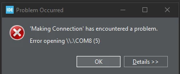

_legacyfs_online_stmicro_images_0693W00000bjX1eQAE.pngThe second you begin a device in run mode, the serial port connection is reset, as a part of the standard workflow of the Nucleo devices, then at that point, the STM32CubeIDE interface breaks (if you attempt to open the viewer shell using Connections->TEST->right click->Open Command Shell):
_legacyfs_online_stmicro_images_0693W00000bjX1oQAE.pngThis means that you simply don't appear to be able to successfully use this feature to monitor a UART port on a Nucleo (or any MCU device) via a virtual COM port through the USB interface on a Nucleo.
