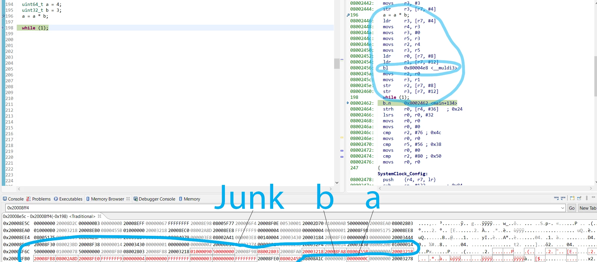

Using:
  • Latest STM32CubeIDE
  • Nucleo-64 G071 (Cortex-M0+)
  • GNU Tools for STM32 (9-2020-q2-update) (default)

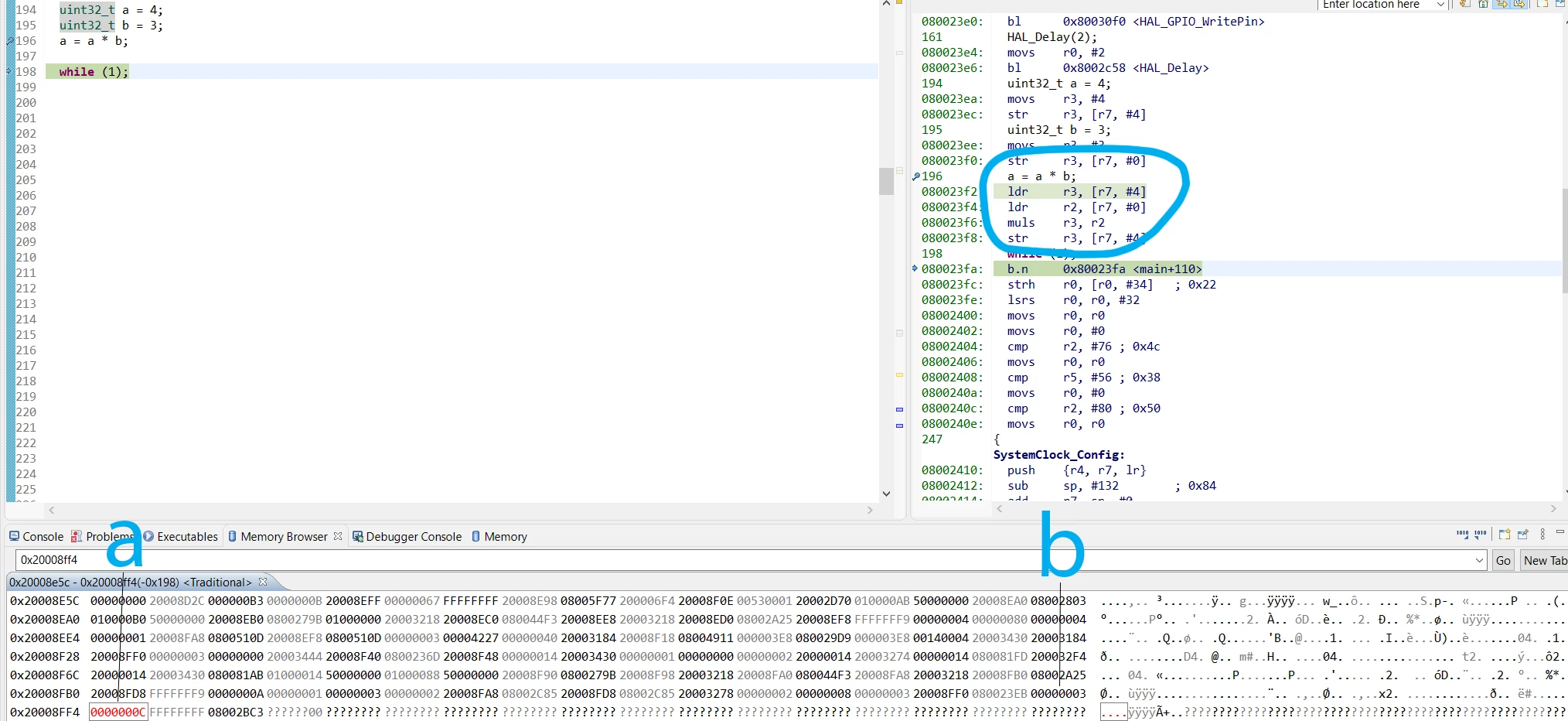

There seems to be a problem multiplying long numbers. Here's what a multiplication of two 32 bit ints looks like.
0693W000008z2cpQAA.pngAnd this is what a multiplication of a 64 bit with a 32 bit int looks like. It works, but in addition to writing the result it also writes a bunch of junk in the memory addresses preceding the variables.
`bl   0x80004e8 <__muldi3>` seems to be the culprit here.
waclawek.jan
waclawek.janBest answer
Apr 8, 2021 7:24 PM UTC
It's normal. What you see changing is the stack.
1 reply
waclawek.jan
