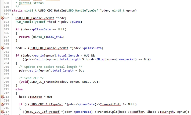

Hallo all,
I am brand new to this forum and quite new to MCU programming and STM32CUBEIDE (v 1.12.1). After some struggle, lots of reading, trying and retrying, I managed to create a project that runs on my Nucleo-L476RG. I already learned to make limited steps and save a copy of each version (simply making a zip-file of the whole project-directory).For completeness: I work on a DELL PC with 12GB memory, running Windows10-Educational.
My project is not too complicated (to my idea): an ADC channel, triggered by OC4REF of Timer4, samples one voltage source at 250kS/s and is configured to write the results to a data-array by DMA. The data array is defined as 'Normal', so the DMA transfer ends when 'array-len' samples are handled. The ADC is also configured to generate an interrupt for 'HAL_ADC_ConvCpltCallback', which calls 'HAL_ADC_Stop_DMA(&hadc1)', 'CDC_Transmit_FS(....)', and 'HAL_ADC_Start_DMA(^hadc........)' to copy the data-array in memory to the USB port, defined by 'USB_OTG_FS' and start the DMA transfer for the following set of data.
I must admit I retrieved the essential parts of the code from a YouTube movie, created by someone who did about the same I want. And after some trail and error (again), I managed to get a stream of reasonable data from the USB port. But an essential problem remained: detection of the begin and end of a dataset in the stream of bytes at the USB-port. I spent a lot of time on several possible solutions in my last version 3.0 and got a new, unexpected and maybe unrelated problem: the code I have is compiled without complaints, can be uploaded to the MCU, but the USB port is not recognized by my PC any more.
When I dig deeply into the sources I find some source files for the USB_port, marked with error-crosses. When I dig further, I see there are some structures missing, like 'USBD_CDC_HandleTypeDef' and 'USBD_CDC_ItfTypeDef' and members of those structures. The "offending lines" are partially marked with red underlining and a "sign" before the line-nr, see the uploaded screenshot. I also saw a file with many lines with an orange underlining, no idea of the meaning.
The overall suspicion I have is that somewhere in the re-generation of the files for the USB a 'define' is missing or corrupted, ending in a non-coherent set of sources. The result is strange: no compiler errors, but an incomplete functionality. I already tried some obvious repairs: clean the project ad rebuild everything, force the code generation by the 'Device Generation Tool' to re-do, but no result.
