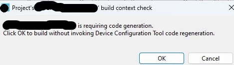

STM32CubeIDE Code Generation Always Runs
STM32CubeIDE 1.17 on Windows 11. When I build a project (right click on project in project explorer) code generation _always_ runs, even though IOC file is unchanged....
Project clean does not help. Annoying but not a problem yet. Makes me wonder what else is going wrong.

Looking at other posts... Changed "isbadioc=true"  to false which gets rid of code generation dialog until I change the IOC file. Then the dialog returns for every build, even if IOC file unchanged.
