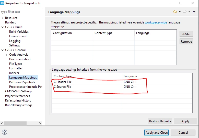

I am having some trouble getting the STM32CubeIDE to work with C++ on my STM32F4 Project.
I have converted my project to a C++ project and Renamed source files withing the IDE.
This works ok and compiles fine. with g++ being used to compile the .cpp files.
However every time I use the .ioc generation tool, it remakes a new main.c file instead of updating my main.cpp file.
My First question is, is there an option I am missing that will change the code generation to generate .cpp files?
If not, my second plan of attack is to force use of the g++ compile on all the .c files using the language mapping dialog, this way I can continue to use the auto generation while using c++ features:
However this does not seem to have an effect and the c files are still compiled with gcc:
I would prefer to use the autogenerator, any help/advice is appreciated.

As of the previous update, STM32CubeIDE/STM32CubeMX was not set up to generate C++ directly. Not sure if the latest update changed it.
