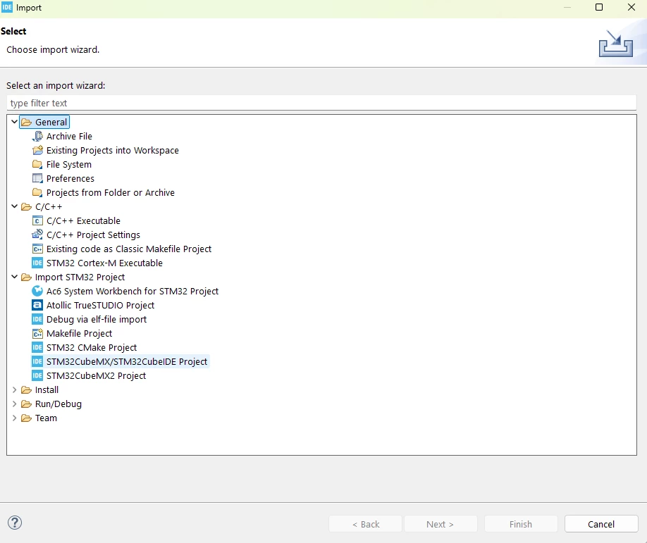

I am trying the NUCLEO545RE-Q. I created a project, imported it to STM32CubeIDE 2.2.0. The build button is grayed out. I found several videos for version 2.0.0 where is easy and straight forward. With this version is not and I couldn’t find any help. What am I doing wrong?

Hello ​@Ecapone
It looks like the project was imported using the wrong method. For a project generated by STM32CubeMX, the recommended way in STM32CubeIDE 2.2.0 is to use File → Import → Import STM32 Project → STM32CubeMX/STM32CubeIDE Project
Also , I recommend trying the import again in a new workspace

EcaponeAuthor
Visitor
Jul 21, 2026 1:20 PM UTC
Ghofrane,
Yes. I did that yesterday and it worked this time. Thank you very much for your replay and help. I appreciate it.
