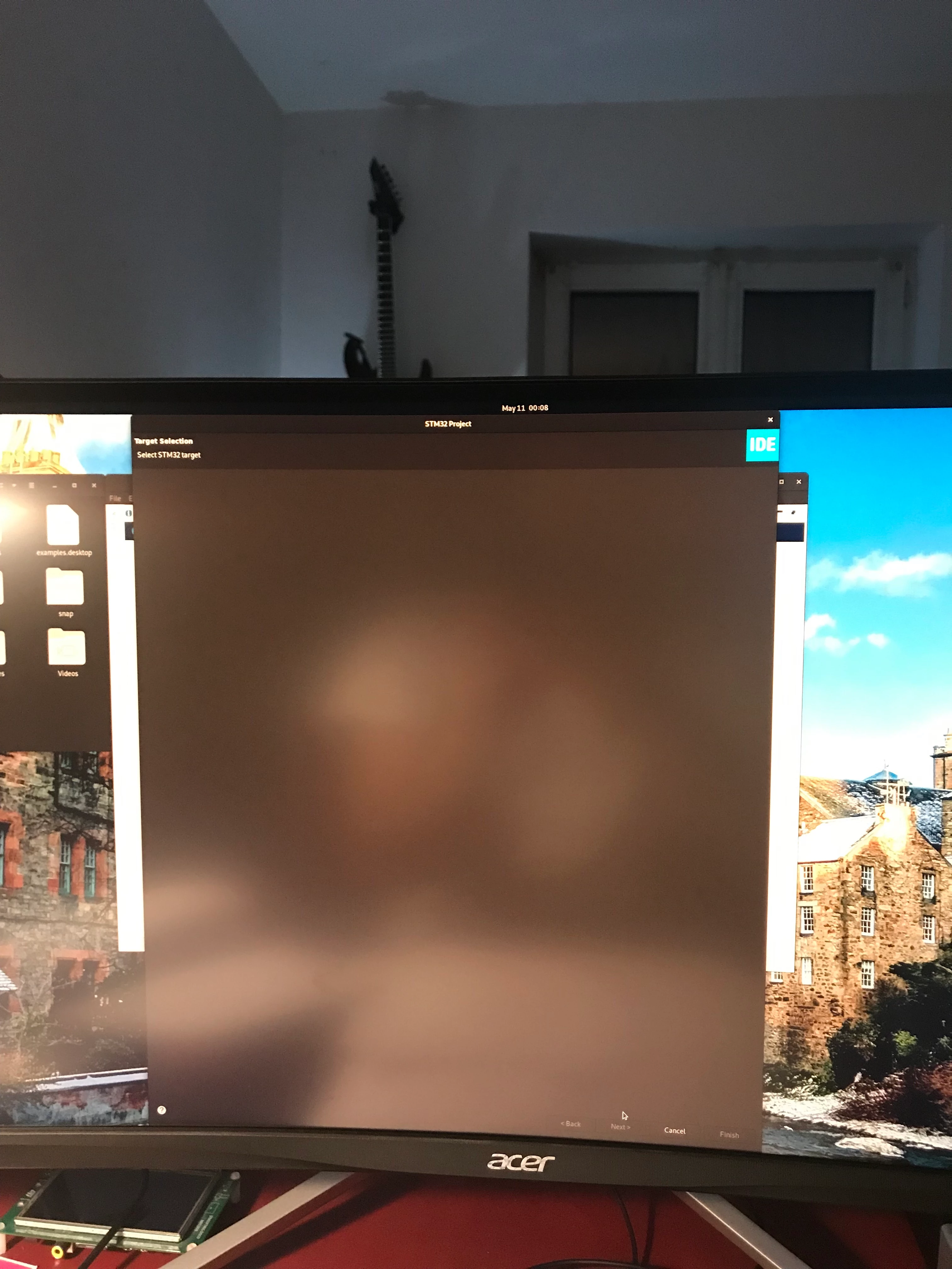

Title says it all. I cannot create a new project - the model dialog for 'select STM32 target' is blank.
Freshly installed the from .deb_bundle.sh installer without errors.
Running Ubuntu 19.04 with vanilla gnome-session installed.

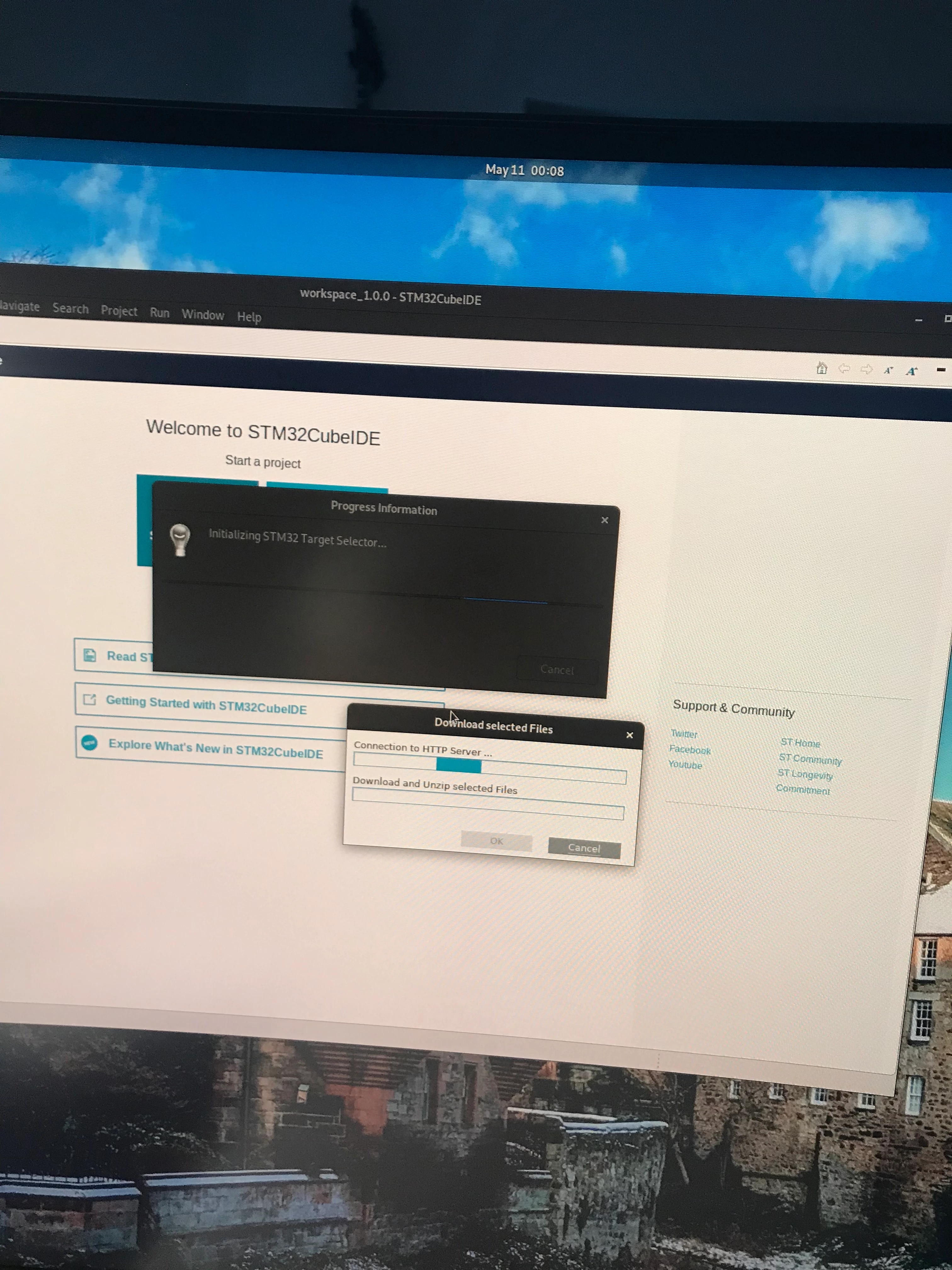

Under windows, there was a lengthy (relatively) download of some files before the 'select stm32 target' appeared and I could easily set up a blank project for my 746GDiscovery, which worked straight away right down to debug stepping.
This download appears to be attempted occasionally under ubuntu19.04, but often is so brief i couldnt take a screenshot. See:0690X000008BYULQA4.jpg
Note, the eclipse internal internet browser does have access to the internet.
This is what is displayed, where there should be a bunch of project config stuff. Sorry for the rotated photos, they were right way up on my PC.0690X000008BYUVQA4.jpg

I believe you might have to resize/move/hover over the MCUFinder window to make it draw. I've seen some (not as serious as this) similar window issues and then a resize of the window has helped for me. We're working on improving the integration of CubeMX and MCUFinder even further.

I will try again, but this was the first thing I tried, as I noticed it was quite large for a modal dialog. I wasn't able to push it draw anything.

I could not get it to draw anything.

I deleted my workspace and relaunched. This time it downloaded some files and presented the gui. i think somehow if it fails this download process it is getting into a state where it doesnt try again.

Hello all, I'm using Fedora 29, and the STM32 Target Selector windows is blank if I use the Gnome on Wayland session, but it draws correctly if I use Gnome on XOrg or Gnome Classic session. The same happens with the newly released Fedora 30.
I hope someone can guess why it is not possible to use Wayland session.
