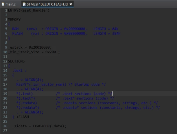

I don't find any options to change the font color for some files like linker scripts (for C/C++ Files it's ok). It's very difficult to read the file and i would like to use the dark theme.
0693W00000HoeQSQAZ.pngSame thing for not included code :
Maybe one of you is aware of the STM32CUBEIDE font options possibilities ?

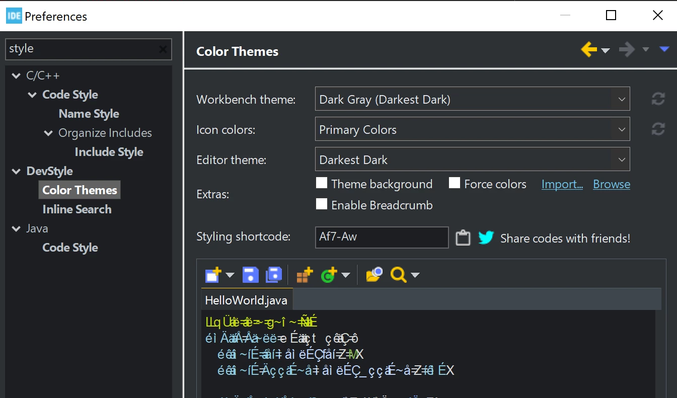

Welcome, @AdrienC​, to the community!
I'd recommend to use the theme DevStyle, see some hints here, which also apply to the STM32CubeIDE.
Regards
/Peter

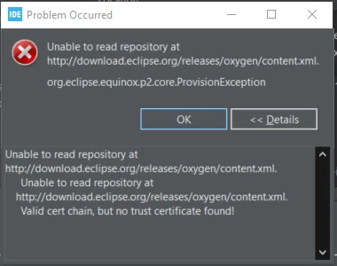

AdrienC
AdrienCAuthor
December 15, 2021
Thank you @Peter BENSCH​ !!!
I work behind a proxy which doesn't allow me to access this url.
I'm able to use offline installer.
Do you know an other way to install this kind of modules ? Thank's
Peter BENSCH
December 15, 2021
A proxy shouldn't be a problem if you enter the proxy data under Window > Preferences > General > Network Connections: host, port, authentication (login, pwd).
In addition, you can set the active provider to e.g. Native and see if you can install Oxygen/DevStyle.
No, I don't know of any offline installer for this, but maybe someone on the Eclipse forums does.
Regards
/Peter
December 15, 2021
I use Dark Gray (Darkest Dark) and it shows up pretty well with the exception of comments in linker files.
