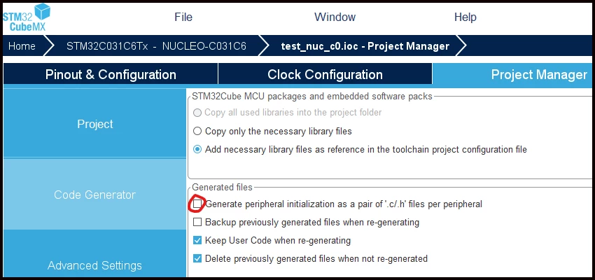

Everything is in the title. I'm not sure at which point I changed the structure to Advanced (probably when trying to debug), but I ended up with a massive main.c file. Now, the Application Structure cannot be changed. Do I need to remake the project from scratch, or is there a way to revert to basic?

From looking around, the project structure is meant to be fixed on project creation, but you can edit it manually within the IOC file in a text editor.
??? Do you actually mean, create separate c & h files for each peripheral?

I apologize, this was indeed a separate issue..
