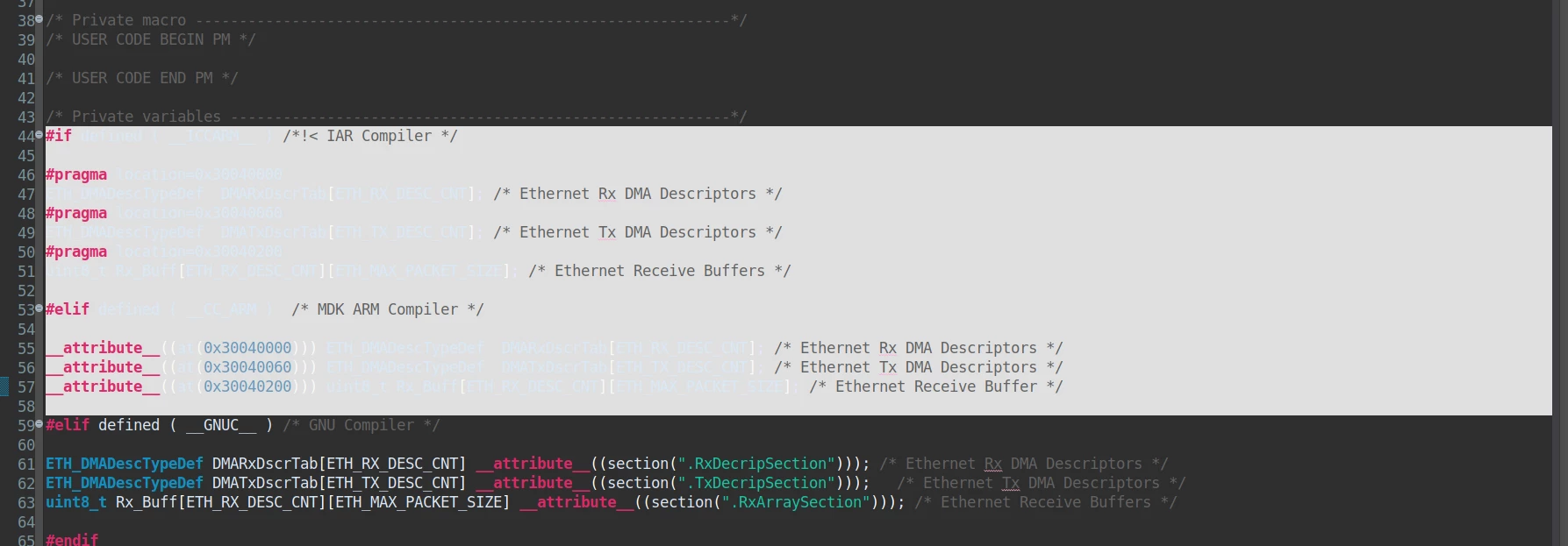

  1. In the attached file "Invisible_Text.png" you can see the light background so that the text cannot be seen. I can't find this context in "Window -> Preferences -> General -> Appearance -> Colors and Fonts". This background color cannot be found there either. How/where can I change it?

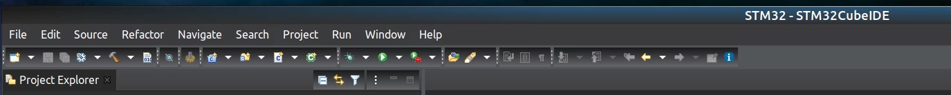

  2. A few days ago I received a new monitor with UHD/4K resolution. The icons in the toolbar are too small (see appendix, file "Small_Icons.png"). I can change the screen resolution to FullHD, but then everything looks strange. I can't change the size of the icons. Is it really not possible?

The UHD/4K support has been a recurrent complaint, certainly in CubeMX it was a Java side nightmare. ie You want Platform Independence, you get limited/generic control of the UI space.
Using Keil and VS Code on Windows with a 4K display, no issues there.
ST has a pretty low bar on GUI, QA and usability issues, and they often fail to clear even that. Luckily the HW is pretty solid.

But to my problems: I understand the problem with the adapting software for 4k displays, but what is about the color problem? I had this problem with the "old" screen also.
