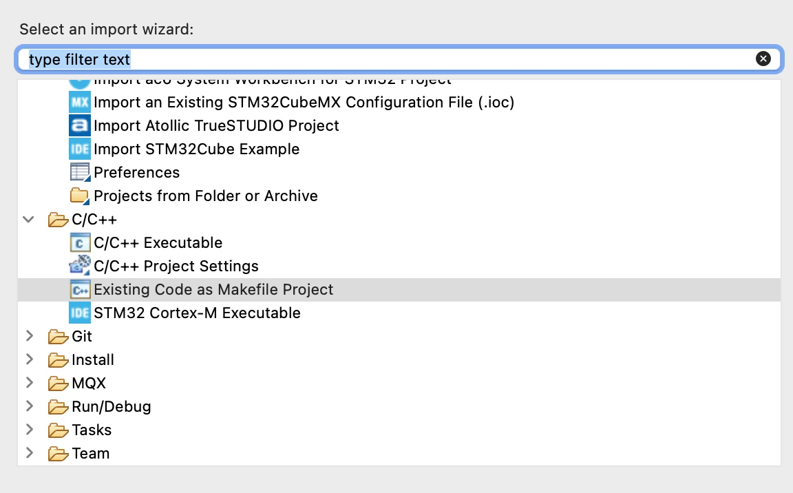

I recently upgraded to macOs14.2 while running IDE@1.13.2. This worked for a while... 2-3h. All the sudden the IDE kept crashing on me. So I upgraded to 1.14.0 which did not solve the problem. I can't even press on the small > icons to drop down additional information like files/settings.
In the console I only get:
/Applications/STM32CubeIDE.app/Contents/MacOS/stm32cubeide
SLF4J: Failed to load class "org.slf4j.impl.StaticLoggerBinder".
SLF4J: Defaulting to no-operation (NOP) logger implementation
SLF4J: See http://www.slf4j.org/codes.html#StaticLoggerBinder for further details.
1 : Invalid condition id : UX_CORESTACK_Condition cause : null
[1] 22798 trace trap /Applications/STM32CubeIDE.app/Contents/MacOS/stm32cubeide
I already tried a new workspace. W/o success.
Every time I try to open a drop down menu it crashes (like Git, Install, ...). If it's opened already it's fine.
Need help. Thanks!

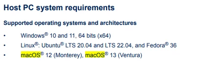

    Hello @JE_it and welcome to the community,
    According to the release note of STM32CubeIDE 1.14.0,  macOs14.2 in not a supported operating system.
    You can use only macOs 12 and macOs 13, as shown in the following screenshot.
    BR,
    Rim
    JE_itAuthorBest answer
    Hi Rim,
    thanks for your reply. I can confirm that the operating system was the issue. macOS 14.2 beta4 (current public beta) is the cooperate. I used time machine to downgrade to 14.1.1 which works.
