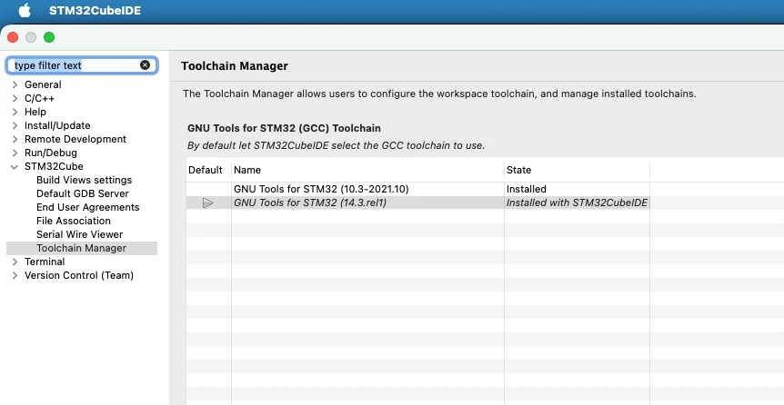

STM32CubeIDE 2.2.0 for mac os( apple silicon ) with GCC ARM for STM32 10.3-2021.10: nullgcc error
I have just installed STM32 Cube IDE 2.0.0 for Mac OS Apple Silicon, and then installed the GCC ARM for STM32 10.3-2021.10 toolchain through the toolchain manager. However when I import a project using this toolchain I get the nullgcc error.
I also tried creating a new project and setting the toolchain to 10.3-2021.10 but still get the same error.
When I look into the eclipse plugins folder searching for the toolchain binaries, I only see a .jar file but not the actual compiler folder with the binaries
ls -l /Applications/STM32CubeIDE.app/Contents/Eclipse/plugins/ | grep gnu-tools-for-stm32
Jul  9 11:22 com.st.stm32cube.ide.mcu.externaltools.gnu-tools-for-stm32.10.3-2021.10_1.2.100.202508251041.jar
Jun 26 11:52 com.st.stm32cube.ide.mcu.externaltools.gnu-tools-for-stm32.14.3.rel1.macosaarch64_1.0.0.202602081740
un 26 11:52 com.st.stm32cube.ide.mcu.externaltools.gnu-tools-for-stm32.14.3.rel1_1.0.100.202601091506.jar
Jun 26 11:52 com.st.stm32cube.ide.mcu.externaltools.gnu-tools-for-stm32_2.2.100.202601091506.jar

Hi Jesus,
same problem here on STM32CubeIDE 2.2.0 for Apple Silicon. The missing compiler folder you
noticed is not a broken download: that toolchain version has no Apple Silicon build at all,
and the toolchain manager cannot tell you so. Here is the root cause and two ways forward.
WHY IT HAPPENS
Every "GNU tools for STM32" toolchain is delivered as two OSGi bundles:
- a descriptor plug-in, the .jar you found, which only contains Java classes describing
  the toolchain
- a native fragment, a directory holding the actual tools/bin/arm-none-eabi-* binaries,
  attached to the descriptor through its Fragment-Host header
Your listing shows the asymmetry exactly:
com.st...gnu-tools-for-stm32.10.3-2021.10_1.2.100.202508251041.jar        <- descriptor only
com.st...gnu-tools-for-stm32.14.3.rel1.macosaarch64_1.0.0.202602081740    <- native fragment
com.st...gnu-tools-for-stm32.14.3.rel1_1.0.100.202601091506.jar           <- descriptor
14.3.rel1 has a macosaarch64 fragment, 10.3-2021.10 does not. Its only macOS fragment is
the Intel one, named ...10.3-2021.10.macos64_<version>, and its manifest carries this line:
Eclipse-PlatformFilter: (& (osgi.os=macosx) (osgi.arch=x86_64))
On Apple Silicon the JVM reports osgi.arch=aarch64, so p2 silently filters that fragment
out and installs the descriptor alone. The descriptor then resolves its tools directory
through a fragment that never attached, the path comes back null, and the build
concatenates it with the tool name. That is literally where your "nullgcc" and "nullg++"
come from.

Jul 21, 2026 10:05 AM UTC
Hello ​@jesusmtz,
Thank you for sharing this request. I have already reported it to our development team for investigation under this internal ticket number CDM0064534.
In the meantime, have you tried to you to use Intel environnement with Rosetta?
Regards,
Aimen
jesusmtzAuthor
Jul 21, 2026 12:50 PM UTC
Hi Aimen,
Thanks for the reply.
Yes, I am currently using STM32 Cube IDE 1.19.0, however I am trying to upgrade to 2.2.0 since Apple has announced is ending the support for Rosetta, and I get I notification to update stm32cubeide.
So it would be really helpful if I can fully migrate to the apple silicon version :)
I have not the Intel 2.2.0 version
Regards,
Jesus Martinez

Homebrew, ...), register it in the IDE under the MCU toolchain preferences as a local
toolchain, and select it in the project properties.
Be aware that this is a real change: a different GCC major version produces different code
and different image sizes, so do not do it silently on something that has to stay
reproducible.
OPTION B: KEEP 10.3-2021.10
Use this when the project has to stay on that exact toolchain id, for example a shared or
CI-built project you are not allowed to modify. It works, but please read the caveats at
the end.
Step 1: install Rosetta. The 10.3 binaries are x86_64 and stay that way.
softwareupdate --install-rosetta
Check it with:
arch -x86_64 /usr/bin/true && echo "Rosetta OK"
Step 2: get the native fragment. The folder
com.st.stm32cube.ide.mcu.externaltools.gnu-tools-for-stm32.10.3-2021.10.macos64_<version>
is part of any Intel STM32CubeIDE installation, under
STM32CubeIDE.app/Contents/Eclipse/plugins/. Copy it from an Intel machine, from an older
Intel installation, or unpack the ST plug-in zip of that toolchain if you have one. Put it
in ~/toolchains for the moment.
If it came from a zip or a download, clear the quarantine flag recursively:
xattr -dr com.apple.quarantine ~/toolchains/com.st.stm32cube.ide.mcu.externaltools.gnu-tools-for-stm32.10.3-2021.10.macos64_1.1.200.202402032213
Clearing only tools/bin is a trap that cost me an hour. The compiler driver then runs, but
macOS kills the still-quarantined backend tools/lib/gcc/arm-none-eabi/10.3.1/cc1plus, and
every compile dies with a misleading message:
arm-none-eabi-g++: fatal error: Killed: 9 signal terminated program cc1plus
Test the compiler itself before going further:
~/toolchains/com.st.stm32cube.ide.mcu.externaltools.gnu-tools-for-stm32.10.3-2021.10.macos64_1.1.200.202402032213/tools/bin/arm-none-eabi-g++ --version
Step 3: copy the fragment into the IDE. Back up the bundle list first.
cp -n /Applications/STM32CubeIDE.app/Contents/Eclipse/configuration/org.eclipse.equinox.simpleconfigurator/bundles.info /Applications/STM32CubeIDE.app/Contents/Eclipse/configuration/org.eclipse.equinox.simpleconfigurator/bundles.info.bak
cp -R ~/toolchains/com.st.stm32cube.ide.mcu.externaltools.gnu-tools-for-stm32.10.3-2021.10.macos64_1.1.200.202402032213 /Applications/STM32CubeIDE.app/Contents/Eclipse/plugins/
Step 4: correct the platform filter. Open this file in a text editor:
/Applications/STM32CubeIDE.app/Contents/Eclipse/plugins/com.st.stm32cube.ide.mcu.externaltools.gnu-tools-for-stm32.10.3-2021.10.macos64_1.1.200.202402032213/META-INF/MANIFEST.MF
and change the single line
into
Eclipse-PlatformFilter: (& (osgi.os=macosx) (osgi.arch=aarch64))
That filter only governs OSGi bundle resolution. The binaries keep running as x86_64
through Rosetta, so pointing it at the JVM architecture is all that is needed.
Step 5: register the fragment. Append this single line to bundles.info, the file you
backed up in step 3 (it is one long line, no line break):
com.st.stm32cube.ide.mcu.externaltools.gnu-tools-for-stm32.10.3-2021.10.macos64,1.1.200.202402032213,plugins/com.st.stm32cube.ide.mcu.externaltools.gnu-tools-for-stm32.10.3-2021.10.macos64_1.1.200.202402032213/,4,false
Everywhere above, replace the version 1.1.200.202402032213 with whatever your fragment
folder is actually called.
Step 6: verify. The grep from the top should now print two lines for 10.3-2021.10, one
.jar and one directory. Then build your project; nullgcc should be gone. If the IDE does
not pick the fragment up, start it once with -clean so the OSGi bundle cache is discarded.
A headless build is the quickest check and also works from a script:
/Applications/STM32CubeIDE.app/Contents/MacOS/stm32cubeide --launcher.suppressErrors -nosplash -application org.eclipse.cdt.managedbuilder.core.headlessbuild -data /tmp/ws_verify -no-indexer -import /path/to/YourProject -cleanBuild YourProject/Debug
CAVEATS FOR OPTION B
- This is not supported by ST. You are telling OSGi that an x86_64 fragment is aarch64.
  That is true enough for bundle resolution and for nothing else.
- An IDE update undoes it. Updates replace plugins/ and bundles.info, and nullgcc comes
  back. Keep the bundles.info.bak and redo steps 3 to 5.
- Rosetta has to stay installed. Remove it and the build fails with "bad CPU type in
  executable" instead, which a makefile reports as the unhelpful "Error 126".
- Editing the app bundle breaks its code signature. Harmless in practice here, but worth
  knowing.
- Compiles run under Rosetta, so expect them to be noticeably slower than with the native
  14.3 toolchain.
