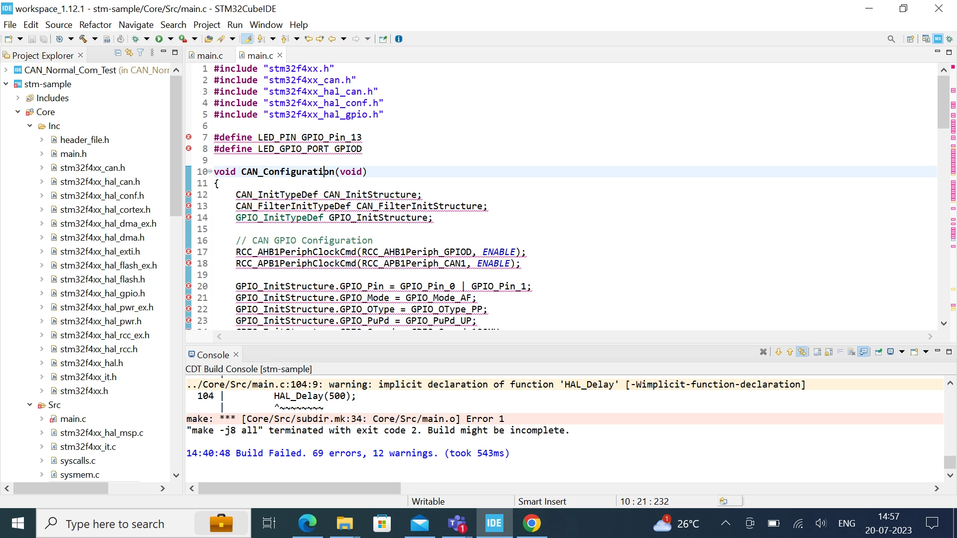

we are trying to execute the CAN messages here we get error we are added header files but it give same error
please tell me how to resolve that error

    Hello
    try to #include "main.h" in the first line, probably other includes not needed. Inside of "main.h" should be #include "stm32f4xx_hal.h" which includes then "stm32f4xx_hal_conf.h" which includes needed hal- modules.
