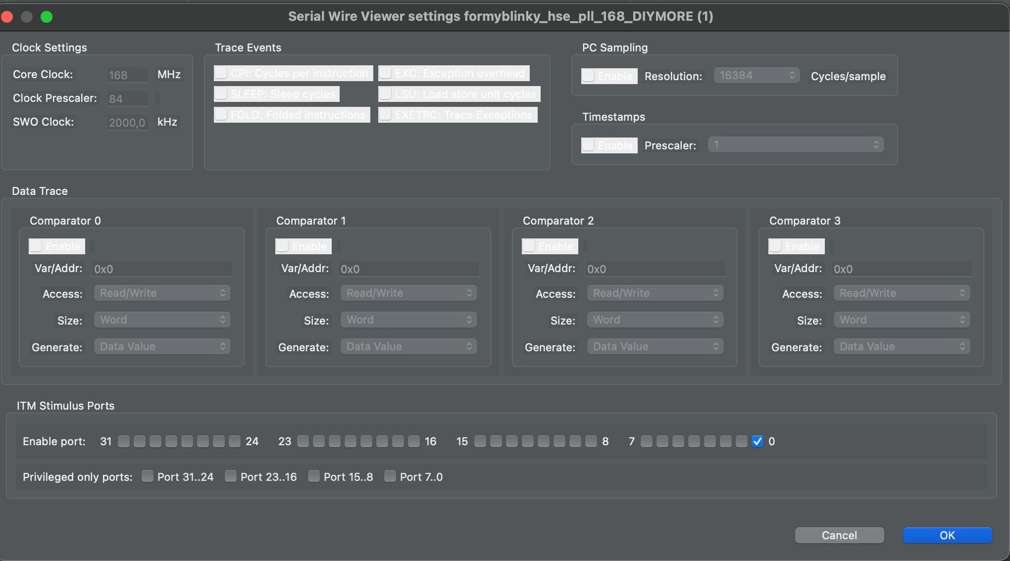

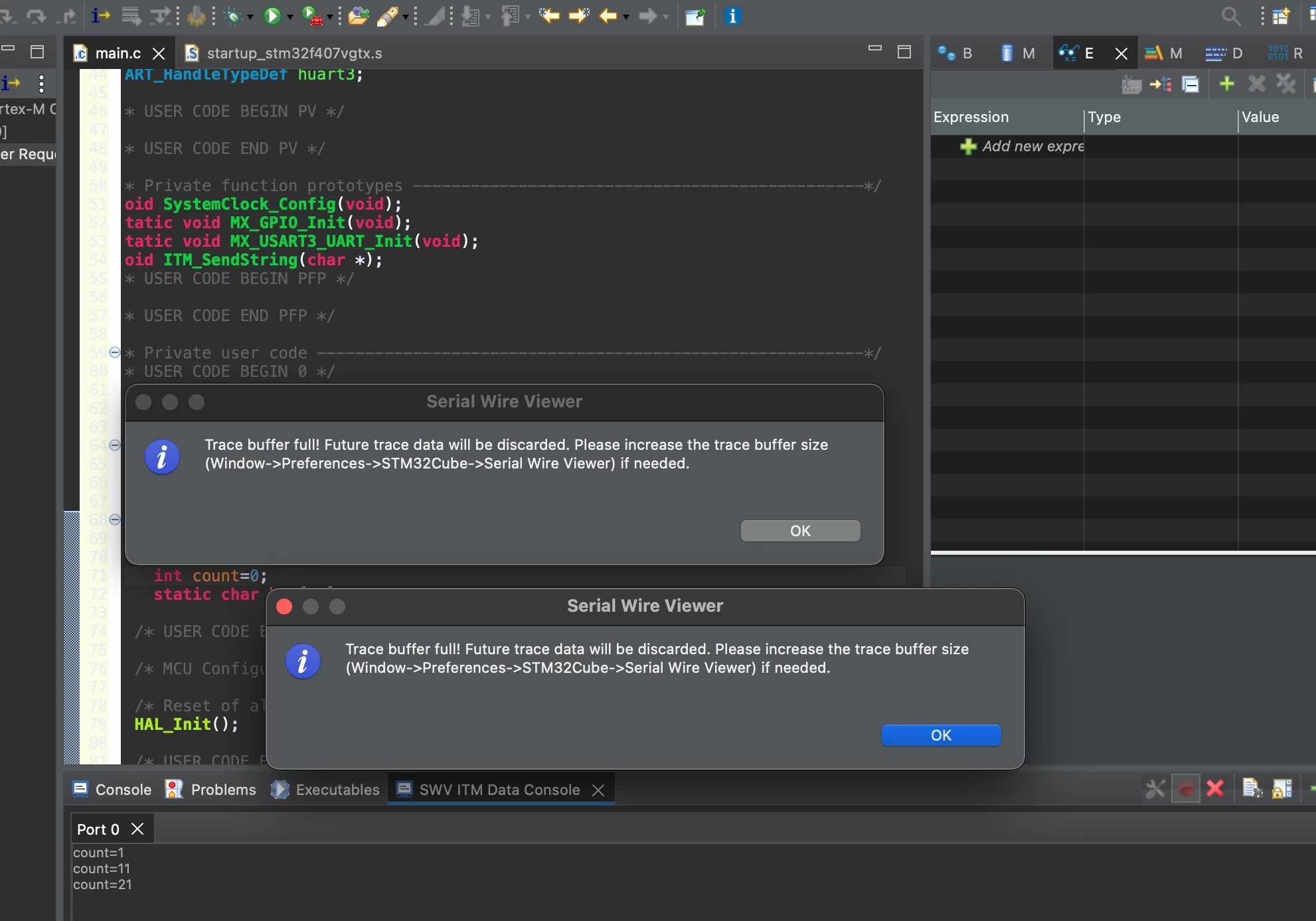

When I run the debug configuration, the trace buffer overflow occurs. It is currently set to 2,000,000. Increasing it to 10,000,000 just makes the overflow happen somewhat later.
OTOH, I'm wondering why such a small debug printf every 5 seconds or so, can cause a buffer overflow.
Core Clock is 168MHz, divider is set to autodetect. I see a value of 86 or so and 2000 KHz max SWO clock.
Any clues why this happens?

Found the problem: in the settings for the SWV ITM Console I had - without thinking about it - ticked on "Trace Events". These lead to the overflow.
