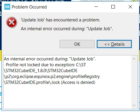

On that machine I was indeed lacking access rights to the .\configuration folder. Fixing only that did still not solve the problem completely: I was then able to start the IDE. Shortly after startup, I got the following error message: 'An internal error occured during: "Update Job". Profile not locked due to exception (...) .lock (Access is denied)".
0693W00000LwGuoQAF.pngI was finally granted access rights to the whole parent folder STM32CubeIDE. I still don't understand why I don't have these issues on my local machines as both must have been installed by administrators (IT department or colleages with more privileges).
