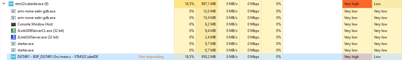

STM32CubeIDE 1.6.1 stops responding, stuck forever in "Build project", on Windows 10
Operating System: Windows 10 Pro, Version 20H2, Build 19042.964.
I just open a workspace that used to work fine. Just let it sit there, doing nothing. The option Project->Build Automatically is disabled. Tried and disabled Indexer, but to no avail!
Some weird Build Project thread gets started, which never ends and prevents any other operation. Even trying to edit a source file is stopped, due to this mysterious "build" in progress. You get the message "The user operation is waiting for background work to complete."
After a while the IDE stops responding altogether, the load on the CPU is Very high, and the only possible thing to do is terminating it from the Task Manager.
The following occurred while debugging through Segger J-Link, but it may happen in any circumstance, even while just editing.
Extremely frustrating! :persevering_face:
Has anybody else faced such situation? Any solution/workaround found?
Thank you very much for any help you may provide.

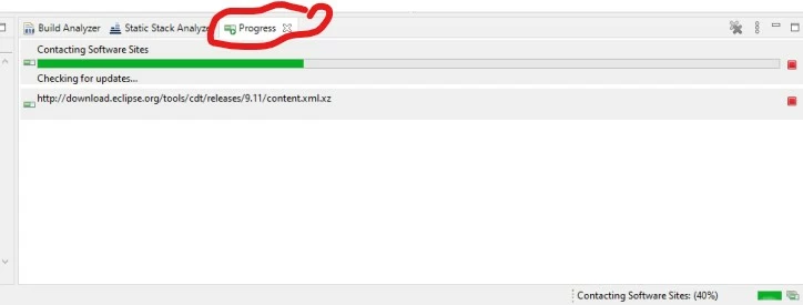

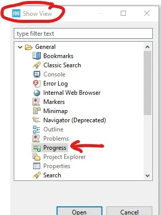

@Osto​ sounds you're facing performance issue if embedded MX usage. Here @GC.Selene​ is reporting build time issue I'm not sure both issues are related.
@GC.Selene​ is your workspace include a single project or multiple ones ? If multiple ones are all STM32CubeIDE projects or a mix of some other nature ?
Then CPU running high any info as part of Progress view (Windows > Show View)?
Osto
Senior
May 18, 2021
Nothing happens in Progress. It happen in system with one project and also multiple project in the same workspace.
