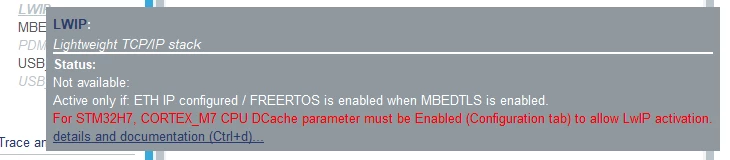

Hi @RDos​ ,
LWIP is grayed because DCache is disabled in CORTEX_M7 configuration. Just enable it and all will be OK.
This is what the popup says when LWIP is grayed:
Try it this way, and let me know if you still face an issue.
-Amel

Hi @RDos​ ,
-Amel

Jul 28, 2020 12:26 PM UTC
I'm able to based on your sharing. Sorry to say grayed presentation is bit misleading … but working by the end so Thanks for !

solved the problem
