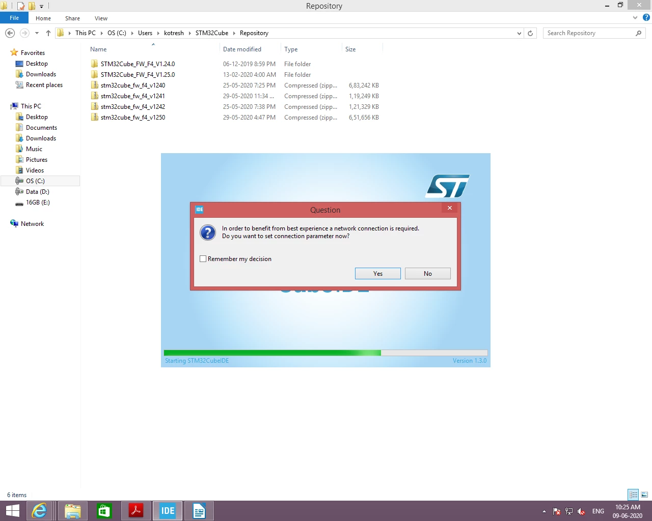

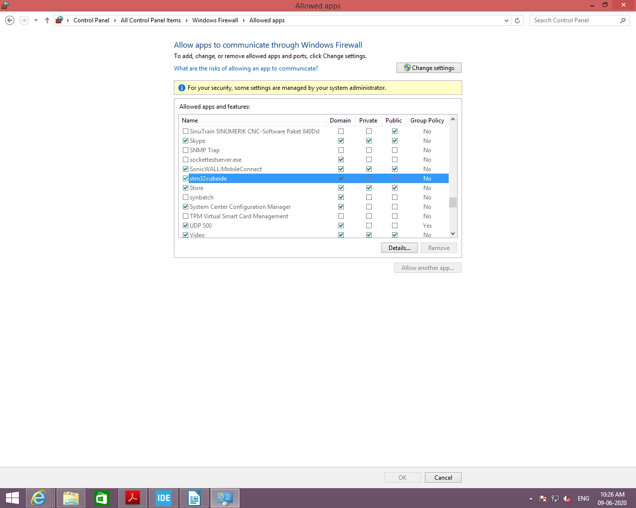

Hi Guys,
I have installed STM32CubeIDE 1.3.0 on my PC which is connected to office network through LAN. Even though  STM32CubeIDE is allowed  to communicate through windows firewall I'm getting network error. One more thing is STM32CubeIDE 1.3.0 is working fine in my development PC which is not connected to the office LAN network.Please go through the attached screenshots to view Network connections and Firewall settings. Can anyone suggest me how to make it work?

I feel some settings in the Firewall or McAfee anti-virus is blocking STM32CubeIDE from connecting to the internet.
I checked with my Networking Team and they are also not able to solve the problem. My IT Team told me that they have allowed the STM32CubeIDE to communicate through windows firewall but still it is not working. What should be the network setting ? Do you have any idea? Please let me know.

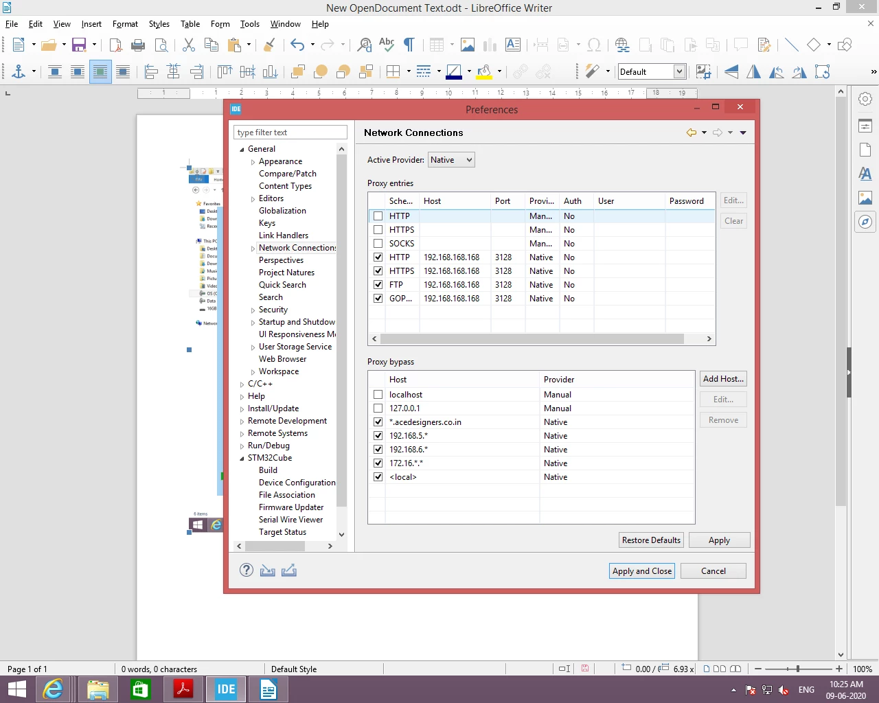

Are you relying on a proxy ?
My company does. If so you have within network connection preference page to select "Manual" mode as active provider. Then fulfill HTTP & HTTPS stuff.
Takes care never fulfill SOCKS keep it as set by default.
For sure until not able to access to Eclipse Market Place no chance to get access to ST remote material.

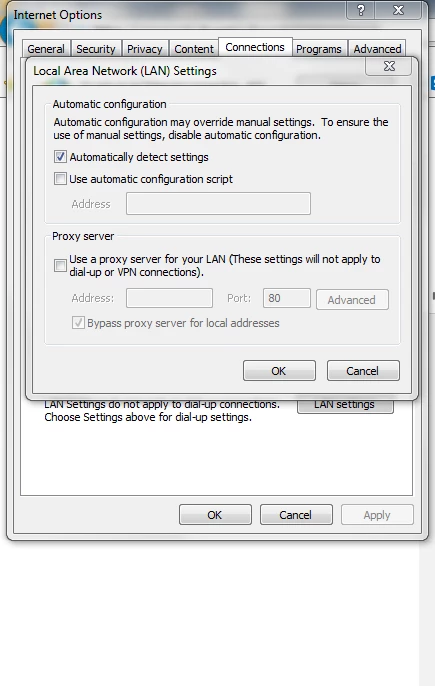

​Hi,
Yes I'm relying on proxy server. "Automatically detect" proxy server setting is selected.
I tried with "manual setting" for proxy server but I don't know which IP address and port number should be entered in the entry fields for STM32CubeIDE.
Please refer the attached image for more information.

Ok. Unfortunately cannot help you more here. You have to know your proxy setup to allow Eclipse to connect outside. If proxy usage no choice you have to fulfill such "Manual" mode info.
Not expert at all about but maybe such can help : https://superuser.com/questions/346372/how-do-i-know-what-proxy-server-im-using
