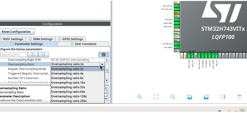

Wrong ADC3 Oversampling Ration selection for STM32H743. It is for STM32H72xx and STM32H73xx, it should a numeric value from 1 to 1024 (RM0433 page 1014).
The generated code will generate an compilation error :
'ADC3_OVERSAMPLING_RATIO_2' undeclared (first use in this function); did you mean 'IS_ADC_OVERSAMPLING_RATIO'?ADC3.png

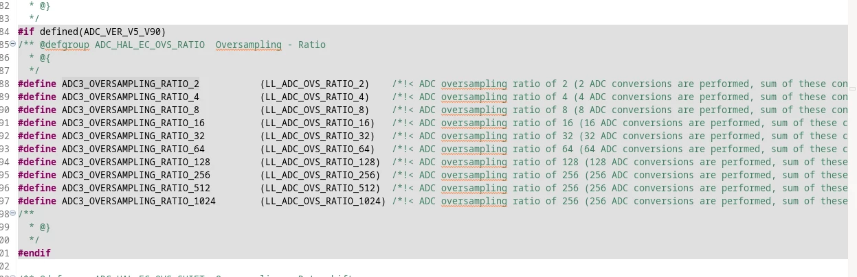

#if defined(ADC_VER_V5_V90)
/** @defgroup ADC_HAL_EC_OVS_RATIO Oversampling - Ratio
#define ADC3_OVERSAMPLING_RATIO_2 (LL_ADC_OVS_RATIO_2) /*!< ADC oversampling ratio of 2 (2 ADC conversions are performed, sum of these conversions data is computed to result as the ADC oversampling conversion data (before potential shift). Applicable for ADC3 on devices STM32H72xx and STM32H73xx */
#define ADC3_OVERSAMPLING_RATIO_4 (LL_ADC_OVS_RATIO_4) /*!< ADC oversampling ratio of 4 (4 ADC conversions are performed, sum of these conversions data is computed to result as the ADC oversampling conversion data (before potential shift). Applicable for ADC3 on devices STM32H72xx and STM32H73xx */
#define ADC3_OVERSAMPLING_RATIO_8 (LL_ADC_OVS_RATIO_8) /*!< ADC oversampling ratio of 8 (8 ADC conversions are performed, sum of these conversions data is computed to result as the ADC oversampling conversion data (before potential shift). Applicable for ADC3 on devices STM32H72xx and STM32H73xx */
#define ADC3_OVERSAMPLING_RATIO_16 (LL_ADC_OVS_RATIO_16) /*!< ADC oversampling ratio of 16 (16 ADC conversions are performed, sum of these conversions data is computed to result as the ADC oversampling conversion data (before potential shift). Applicable for ADC3 on devices STM32H72xx and STM32H73xx */
#define ADC3_OVERSAMPLING_RATIO_32 (LL_ADC_OVS_RATIO_32) /*!< ADC oversampling ratio of 32 (32 ADC conversions are performed, sum of these conversions data is computed to result as the ADC oversampling conversion data (before potential shift). Applicable for ADC3 on devices STM32H72xx and STM32H73xx */
#define ADC3_OVERSAMPLING_RATIO_64 (LL_ADC_OVS_RATIO_64) /*!< ADC oversampling ratio of 64 (64 ADC conversions are performed, sum of these conversions data is computed to result as the ADC oversampling conversion data (before potential shift). Applicable for ADC3 on devices STM32H72xx and STM32H73xx */
#define ADC3_OVERSAMPLING_RATIO_128 (LL_ADC_OVS_RATIO_128) /*!< ADC oversampling ratio of 128 (128 ADC conversions are performed, sum of these conversions data is computed to result as the ADC oversampling conversion data (before potential shift). Applicable for ADC3 on devices STM32H72xx and STM32H73xx */
#define ADC3_OVERSAMPLING_RATIO_256 (LL_ADC_OVS_RATIO_256) /*!< ADC oversampling ratio of 256 (256 ADC conversions are performed, sum of these conversions data is computed to result as the ADC oversampling conversion data (before potential shift). Applicable for ADC3 on devices STM32H72xx and STM32H73xx */
#define ADC3_OVERSAMPLING_RATIO_512 (LL_ADC_OVS_RATIO_512) /*!< ADC oversampling ratio of 256 (256 ADC conversions are performed, sum of these conversions data is computed to result as the ADC oversampling conversion data (before potential shift). Applicable for ADC3 on devices STM32H72xx and STM32H73xx */
#define ADC3_OVERSAMPLING_RATIO_1024 (LL_ADC_OVS_RATIO_1024) /*!< ADC oversampling ratio of 256 (256 ADC conversions are performed, sum of these conversions data is computed to result as the ADC oversampling conversion data (before potential shift). Applicable for ADC3 on devices STM32H72xx and STM32H73xx */
#endif
    Best answer by mƎALLEm
    Thank you for the sharing.
    I reproduced the behavior with V6.11.1.
    The internal ticket 180548 (not accessible by community users) has been opened to confirm and fix the issue.

    Code is greyed out because it is not for STM32H743. IOC uses the defines.

    mƎALLEm
    mƎALLEmBest answer
    May 2, 2024

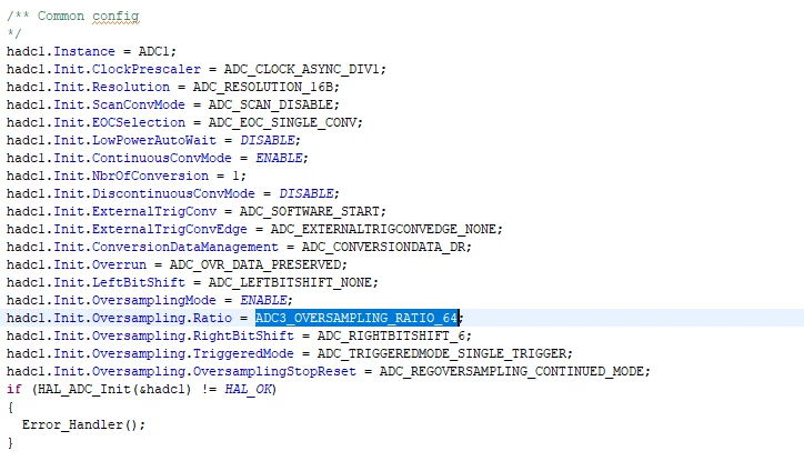

    gvenkatr13
    May 15, 2024
    Similar problem to me after the latest update. Even though I'm not using ADC3. Code generator automatically assigning ADC3_OVERSAMPLING_RATIO_64 when selected oversampling for ADC1 on my STM32H747 project. I'm replacing it everytime with the numerical value.
