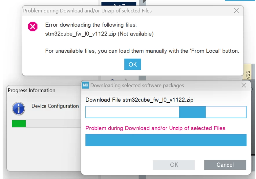

STM32CubeIDE 1.14 Generate Code Error downloading unavailable files
Hallo,
when i will generate code. The message in a message box is:
Error downloading the following files:
stm32cube_fw_IO_v1122.zip (Not available)
For unaavailable files, you can load them manually with the 'From Local' button.
My problem is i can't found the  'From Local' button oran alternative way to download the file.
Best regards
    BitmanBest answer

    many thanks for the support. In the meantime I was able to solve the problem. Two other computers on the same WiFi network were able to download the files. The problem lies with the computer. After I have ended some of the background processes, I can also download the files on the other computer!
    Thanks for your support

    Peter BENSCH
    December 13, 2023
    Welcome @Bitman, to the community!
    Which version of STM32CubeIDE are you using?
    If it is the latest version: are you logged into the IDE with your credentials?
    Regards
    /Peter
    December 14, 2023
    are you sure it is IO in the zip filename ? It looks like L0 in lowercase, huh... Normally the archive name contains the MCU series.
    It could help to know which MCU is in your project.
    BitmanAuthor
    December 14, 2023
    Hello Peter,
    Hello Oskar_H,
    many thanks for your quick answers. The problem occurs when I want to generate code in the STMCubeIDE. The problem is independent of the version of the STMCubeIDE. Testing with 1.8.0 and 1.14.0
    Best regards Bitman
    December 15, 2023
    You did not answer my question about the MCU, I guess you are using an MCU from L0 series...
    Sorry I tried to reproduce but it works fine on my side. I can download the FW pack, install it and build a project using it.
    Have you tried to refresh the FW pack data through menu Help > Embedded Software Package Manager > Refresh ?
    BitmanAuthorBest answer
    December 18, 2023
    Hello colleagues,
