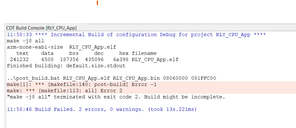

I am still facing issues with post build script not working using STM32CubeIDE v1.14.1 under Windows 11.
My post build step invokes a batch file in the project root folder, however even when this bat file does nothing the build will fail. I've attached a screen shot showing the error.
This post_build.bat file works fine on earlier versions of STM32CubeIDE (although I never tried on v1.14.0) - but I have an earlier version on my work laptop and that works without issue.
Is there any solution?
Thanks,
Simon
EdGi
February 27, 2024
I have exactly the same problem.
Post build batch file working on pre 1.14.0, not working on 1.14.1
Any clues as to what was changed in 1.14.0 and 1.14.1?
*** update ***
I resolved my issue by enclosing my batch command in double-quotation marks.
It seems the post-build command is now intolerant of spaces in the project path.
