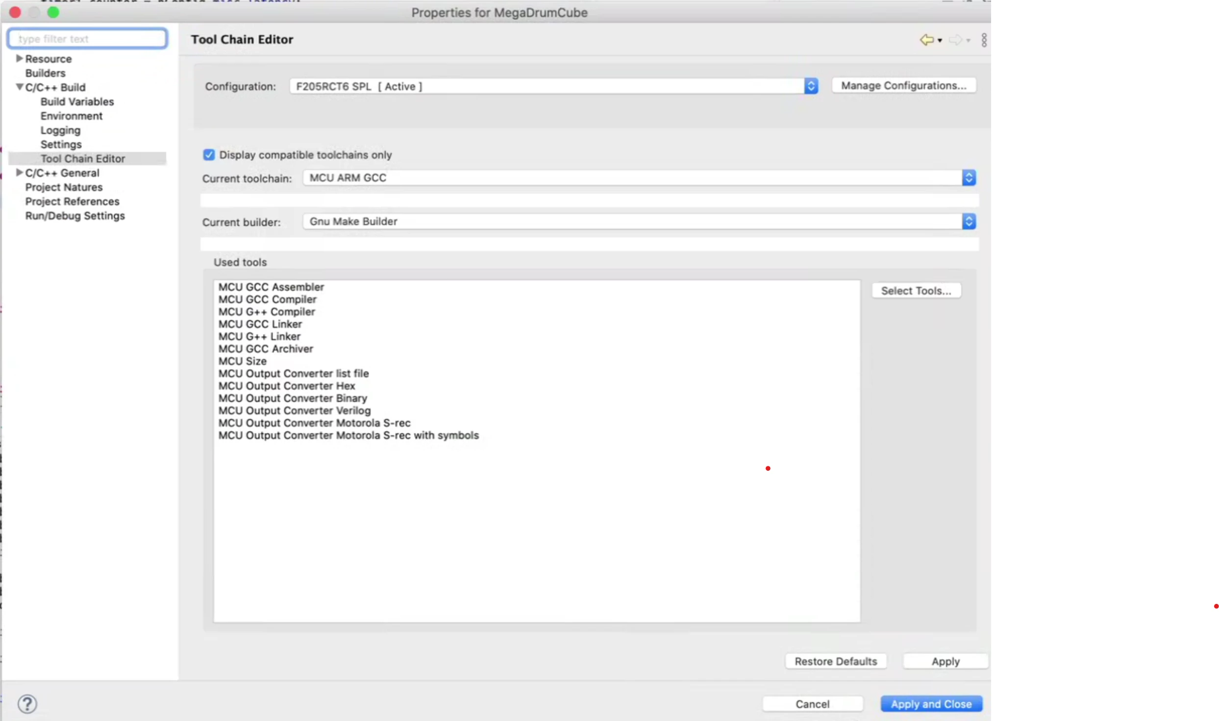

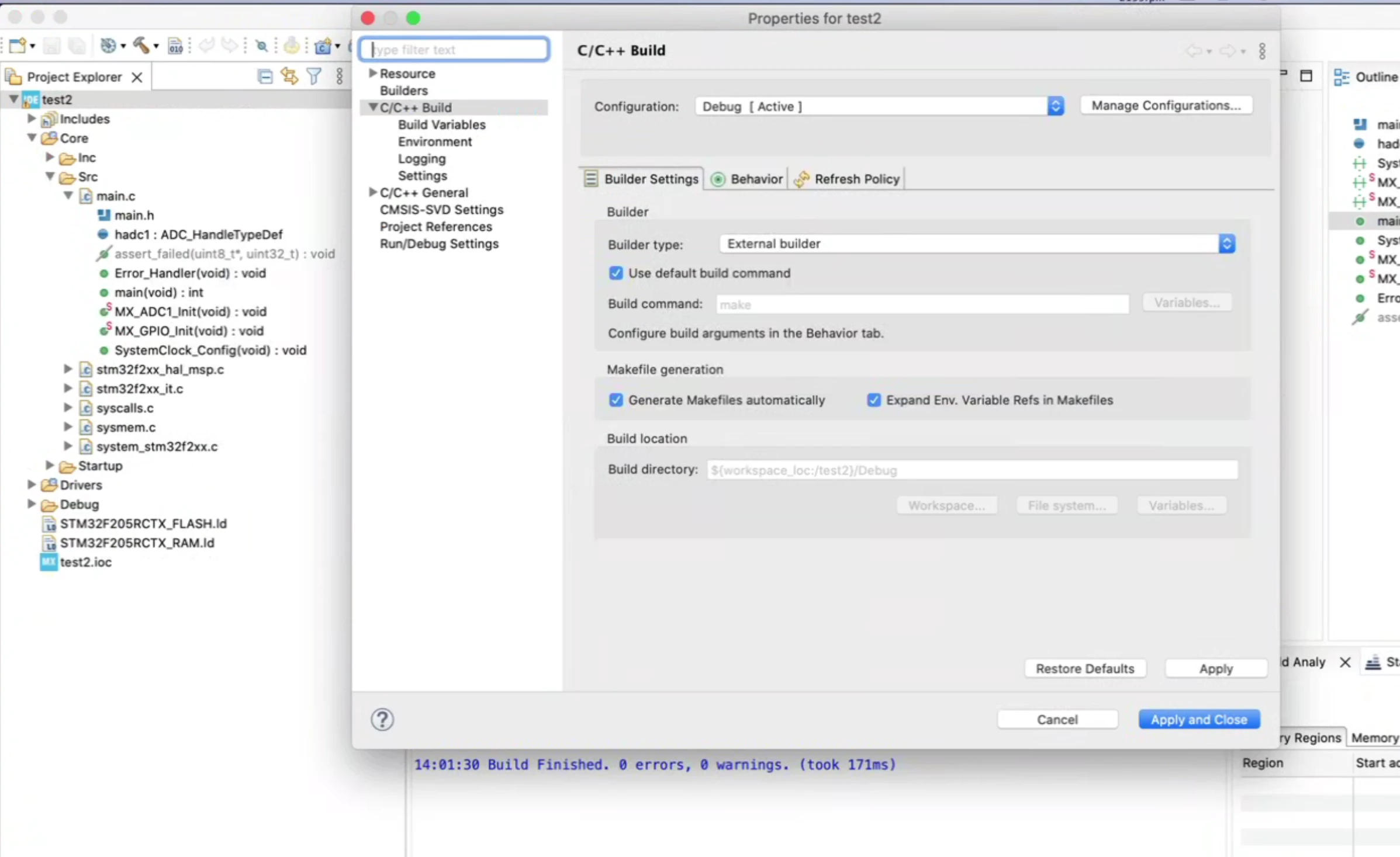

    I don't know if it is relevant but in both 1.13.2 on Catalina and in 1.14.0 on Windows in Projects 'Properties->C/C++ Build' I have 'Tool Chain Editor' subsection but it is missing in 1.14.0 on Catalina.
    1.14.0 on Catalina:
    1.13.2 on Catalina:

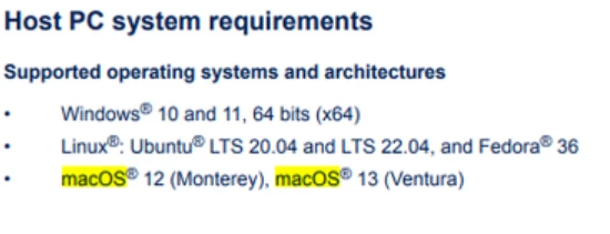

    Hello @kayuk  and welcome to the community,
    According to the release note of STM32CubeIDE 1.14.0, the required  macOs systems are Monterey and Ventura as shown in the screenshot
    Thanks,
    Rim
    kayukAuthor
    December 14, 2023
    I know that, and I stated it the first post. But that macos requirements were there for 1.13.2 yet it was working fine.
