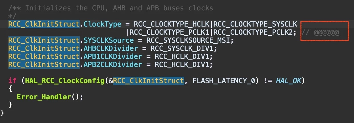

I already wrote a about this to pinned release thread, but as there is no public tracker I don't know if that was the correct place, so I decided to a make a new thread.
On macOS, it is not possible to type '@', because ALT+L is hard coded for 'Login'. It is not shown on Settings->General->Keys, so I can't change the binding. I tried to change it from workspace->.metadata/.plugins/org.eclipse.e4.workbench/workbench.xml, but it doesn't matter if I delete it or change the binding to something else, the Login command will be set back to ALT+L after exiting STM32CubeIDE. On first time after changing the binding, the editor crashes.

Strange!!! As you can see in the attached screenshot, with STMCubeIDE 1.13.2 and macOS Sonoma 14.1, this problem does not occur....
