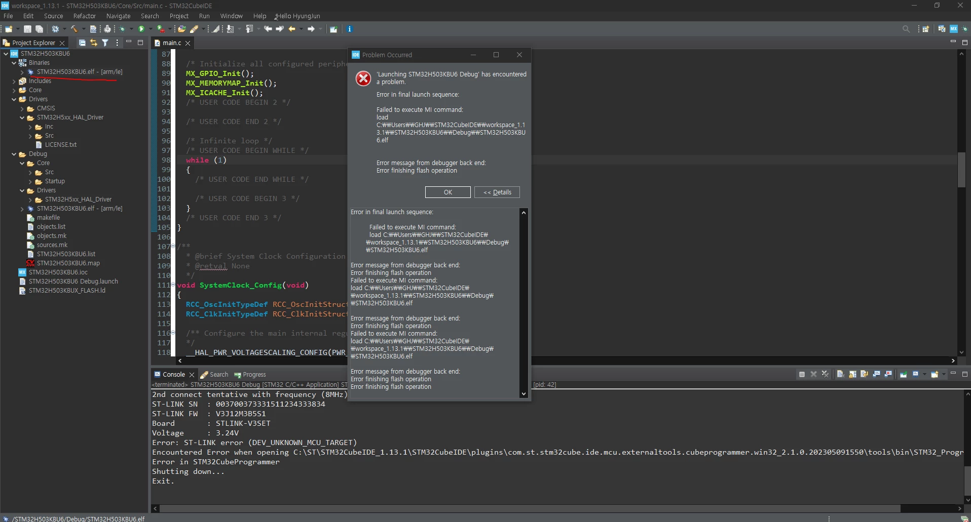

STM32CubeIDE 1.13.1 -> STM32H503KBU6 Download error

Think!
After changing the initialization pin from NJTRST to RESET# pin, normal operation was confirmed.
