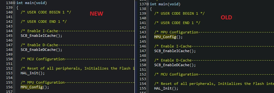

Hello. I have a project which was worked fine about 3 years. But after update to 1.13.0 I am catching a hard faults at start. I am discover that hard fault happens inside MPU_Config(); function. Also I found that new version has change init order:

P.P.S My fix is to add my own MPU_Config(); call in the user section at begin of main(). Now second call generated with CubeMX will not crash program and CubeMX project update will not delete my fix. I think it is temporary solution and hope will be some fix in next Cube Ide version.

    Hi @Yaroslav Vushnevsky
    There is nothing wrong in the MPU configuration.
    Did you changed the order of calling caches enable and MPU according to the old scheme ?
    If you enable D-cache and then configure your data memory (stack or RW data) to be non-cacheable
    (similar to the MPU configuration in new as shown by figure above), some issues may occur.
    In such cases, we recommend cleaning the D-cache just before enabling the MPU.
    Best regards
