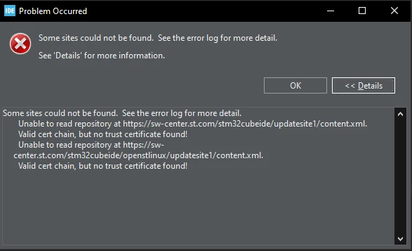

STM32CubeIDE 1.13.0 Major Problems
After updating to STM32CubeIDE v1.13.0 I can no longer generate code from my IOC. This also prohibits me from creating a new project as it can't find the firmware packages. When I hit "manage embedded software" nothing happens.
EDIT: This appears connected to the fact you need to login in to myST from STM32CubeIDE to access the firmware packages. However, nothing happens when I try to log in.

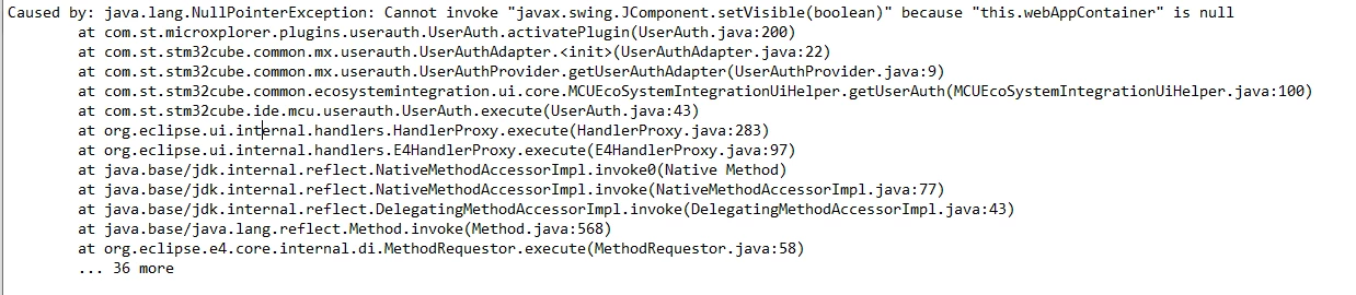

    I've now tried uninstalling and reinstalling and I'm faced with the same issue. Below is what happens when I hit "manage embedded software" from the Eclipse log file:
    When I hit "Check for Updates" I get the following:

    I am having the same problem on Window 11 with STM32CubeIDE v1.13.0
    Semer CHERNI
    July 27, 2023
    Hello @nattayb
    First let me thank you for positng.
    Are you using Windows 11 like @kPettit or an other OS?
    @nattayb and @kPettit could you provide the compete .log from CubeIDE.
    Are you connected with your st account with the user authentication feature?
    Is the issue observed with the STM32CubeMX standalone application?
    KR,
    Semer.
