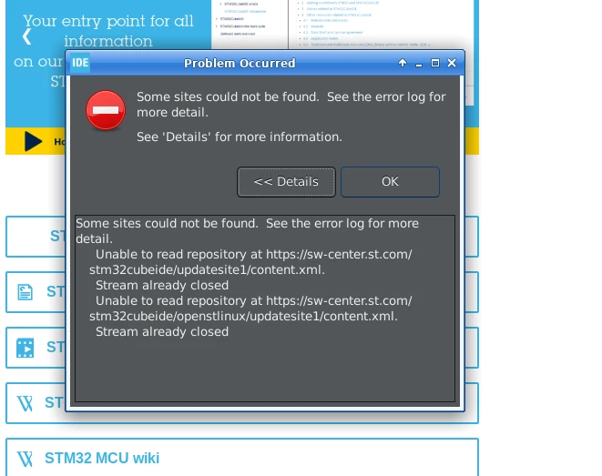

STM32CubeIDE 1.10.1 update repositories not found for linux installation on Ubuntu 20.04
  • August 24, 2022
  • 1153 views
I have installed the stm32cube IDE 1.10.1 on ubuntu 20.04 using the appropriate installer package. Upon full installation when I tried to update the IDE using "check for updates" option in help, I am consistently getting the following update error message:
(attachment 1/2)

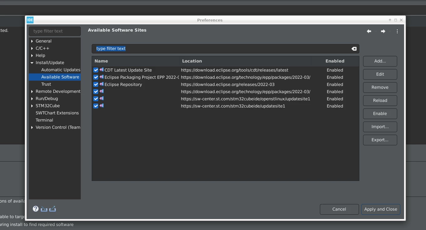

Other default repository URLs for CDT and core eclipse etc are working fine. I am behind a proxy and have configured the proxy settings too.
All default URLs are as follows:
(attachment 1/2)
Hope all this information is useful for resolution of the reported anomaly.

Semer CHERNI
August 24, 2022
Hello @Moitra​
I could not reproduce the issue from my side.
Did you try again the update. Maybe it was a temporary problem with the servers.
Kind regards,
Semer.
Moitra
MoitraAuthor
August 25, 2022
Thanks Semer for the prompt response on the query. After your confirmation, I see that it is the problem of my proxy. I am setting the proxy parameters in the Preferences->general->network connections. Is there any other way I can set the proxy parameters for the repository update to work in my case ???
