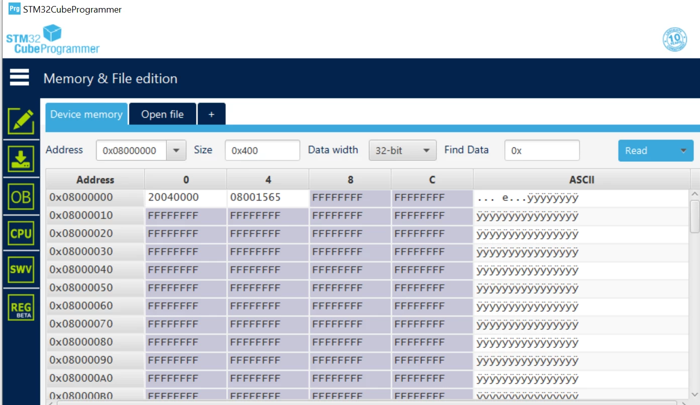

STM32Cube IDE v1.8 not be able to download to Discovery L5 board anymore
I upgraded to v1.8 and realized that my programs cannot be downloaded anymore to my discovery STM32L5 board. The error message says:
Erasing internal memory sectors [0 9]
Download in Progress:
Error: Fail to write buffer in flash
Error: failed to erase memory
Upto that message all other status messages looks fine. I assume it is related to ST-LINK GDB server. Version 6.0.0 because in STM32Cube IDE this was version 5.x.x.
The STM32Programmer is still able to download to the board. If I connect the STM32Programmer right after an unsuccessful download of STM32CubeIDE I can see that parts of the memory get deleted but not programmed correct afterwards (see screenshot attached). The first 8 Bytes are correct. After that only erased memory cells are shown.

mattias norlander
Mar 8, 2022 10:45 AM UTC
Could you try to see if this is working in CubeIDE 1.9.0?
In 1.9.0 (released yesterday) we have:
  • Better auto-negotiation of SWD frequency. On some boards the communication is not stable and the user had to manually select a lower freq. CubeProg stand-alone could already managed auto-negotiation of the SWD freq. But now it is also supported in ST-LINK GDB server. Could explain why it worked in CubeProg but not GDB server... So either try 1.9.0 or manually lower the swd freq in 1.8.0 in debug config.
  • There is also a bit more verbose logging in the GDB server which could give us more hints
  • The launch and terminate sequence of debug has been improved. First dirty-fix came already in 1.8.0. In 1.9.0 we have up-streamed fixes to the CDT platform to get rid of an identified race condition which left ST-LINK in a bad state.

The 1.9 problem was related to Avast antivirus who quarantined silently some files...
With quarantine exceptions, Cube 1.9 works for me.
