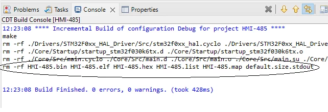

stm32cube ide v1.16.0 remove hex bin and elf files
hi
i read Previous posts and set project properties for generate hex file but i see they remove after they build. why?

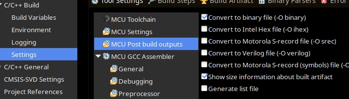

    so you set hex-output here :
    ali_aamAuthor
    July 21, 2024
    yes
    i open new project and change directory from "D:" to "C:" and it solved
