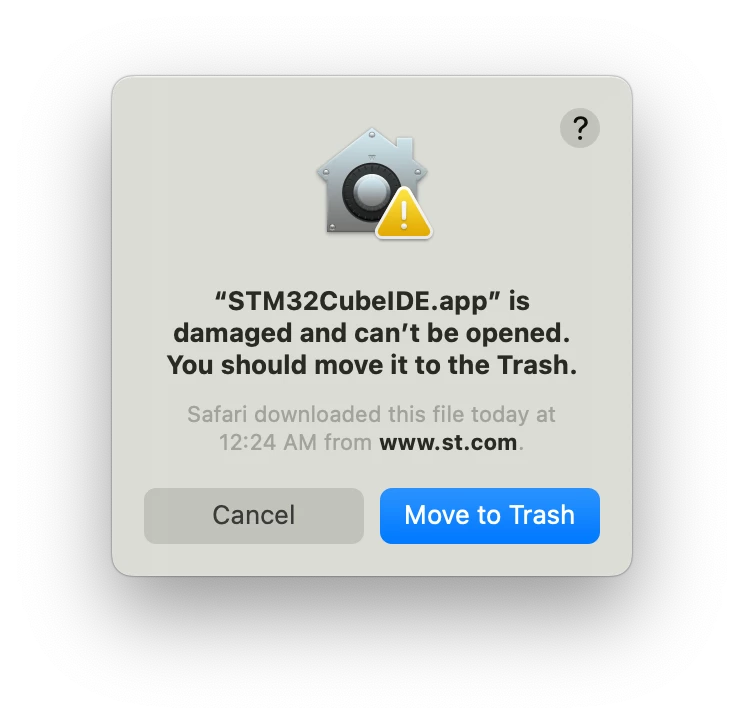

I'm running the latest (less than one week old) macOS Monterey developer beta 12.4 (build 21F5063e) on a MacBook Pro 10,1 and downloaded the file en.st-stm32cubeide_1.9.0_12015_20220302_0855_x86_64.dmg_v1.9.0.zip, decompressed and installed the app. But attempting to start the app causes a hiccup in the macOS first-time verification of the app and produces the following error:
0693W00000LzXVXQA3.pngNotes:
  • Anti-virus software can corrupt downloads. I disabled Avast file and web checking.
  • I tried this download multiple times; same result.
  • Other tools, e.g., MX and Programmer, downloaded, installed and run OK.
Has anyone else seen this? Recommendations?
TIA,
Mike

Hello Mike,
I haven't tested this on Monterey myself but in the STM32CubeIDE installation guide we mention the following command that you can try with the Terminal:
xattr -c /Applications/STM32CubeIDE.app
Could you give it a try and tell me the result?

Markus,
Bingo! That did the trick. Thanks for the suggestion. New one to me. I usually get around the gatekeeper with a right-click open.
