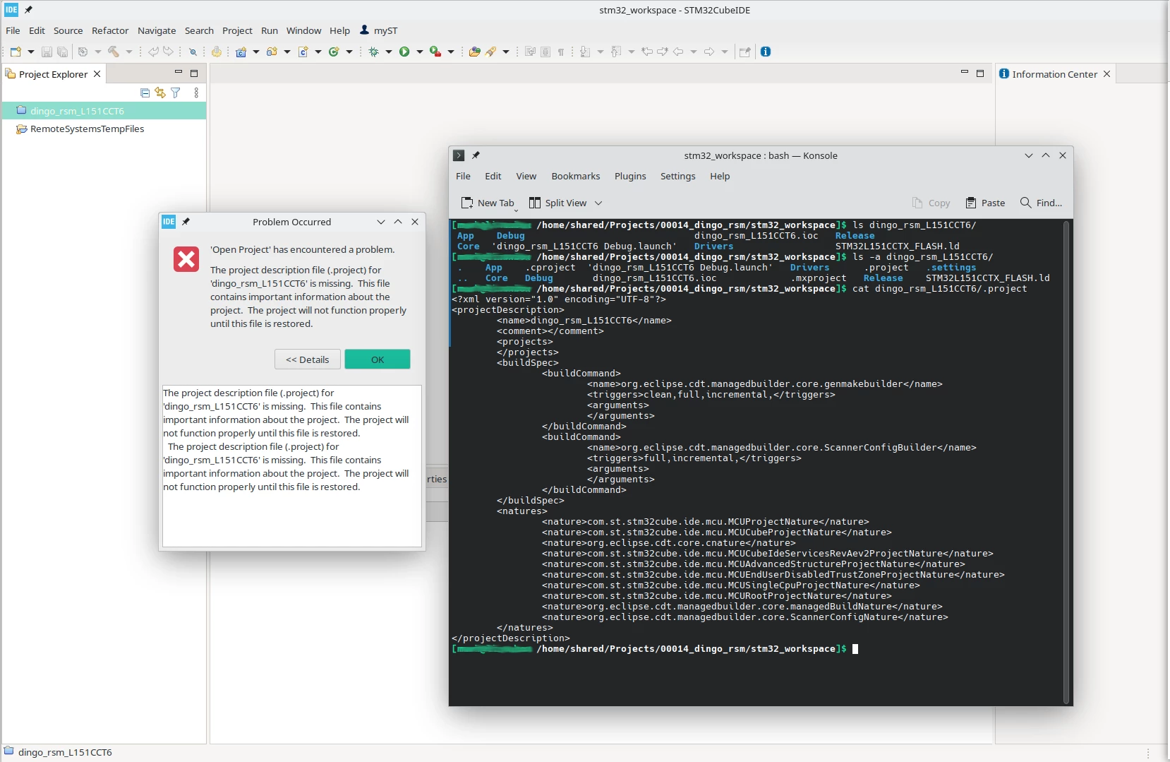

STM32Cube IDE 1.16.0 does not find .project files on Linux
I have recently encountered an issue opening my existing STM32CubeIDE projects on linux.  The IDE complains that there is no .project file, even when it is actually present. Here's screenshot with terminal showing the content of the .project file:
The only thing I can think of that has changed is that I have recently replaced the spinning disk containing the projects with an SSD.  The spinning disk was set up as a single disk RAID array with an XFS filesystem, whereas the new SSD is a standard single disk with BTRFS file system.
Does anyone have any idea what may be wrong?
    mp035
    mp035Best answer
    September 7, 2024
    Ok so after hours of research, it looks like the problem is related to STM32CUBEIDE trying to write log files to a non-existent location (the path /media/mybook_drive/ in the log below no longer exists)
    I fixed the issue by temporarily creating the non-existent path and restarting STM32CUBEIDE.

    2 replies
    mp035
    mp035Author
    August 28, 2024
    Just want to bump this issue.  I am unable to open ANY of my projects at this point, so I am kind of stranded.
    I have tried moving the workspace on to a FAT32 formatted flash drive, just in case it was a file system type problem, but the issue remained.
    Does anyone have any ideas? pointers? suggestions?
    mp035
    mp035AuthorBest answer
    September 7, 2024
    Here's the console log in case someone at ST Micro wants to do something about the issue:
