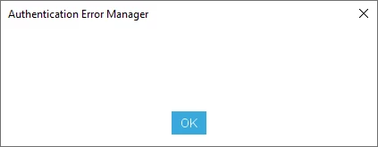

STM32Cube IDE 1.13.2 "Authentication Error Manager"
If I try to log in to myST (Alt-L), I see the throbber throb for a while and then this (unhelpful) dialog pops up
So I can't download firmware.

    When I tried to download the firmware manually from the ST website, I hit a 503, which probably has something to do with the problem.
    Service Unavailable
    The server is temporarily unable to service your request due to maintenance downtime or capacity problems. Please try again later.

    Since you can log in and post messages here, the sign-on server works. Then it can be a temporary outage of content distribution network (CDN) in your area, please try later. (downloading CubeIDE and libraries works for me now, in my area).

    What worked for me was to simply clone it from github.
    https://github.com/STMicroelectronics/STM32CubeF0
    into C:\Users\username\STM32Cube\Repository
    Since the source code is available on github, it's not clear to me why there is a login requirement to download it through the IDE, and it certainly doesn't improve the user experience.
