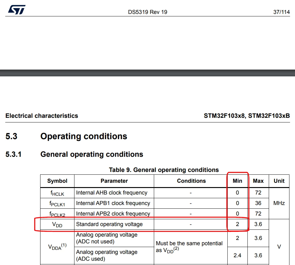

@mekatronik27 wrote:
Voltage : 1.05V
Minimum operating voltage for stm32f103c8 is 2V:
https://www.st.com/resource/en/datasheet/cd00161566.pdf#page=38
I tried it on stm32f103-blupilli and stm32f429disc card
Did they both give the same result?
An STM32F429 will also not work at 1.05V, and the stm32f429disc should be running at 3V.
Definitely something wrong here!
