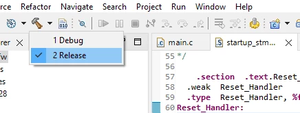

I have implemented the code that you have suggested, then I have built my project using release mode:
And then I just clicked "run"

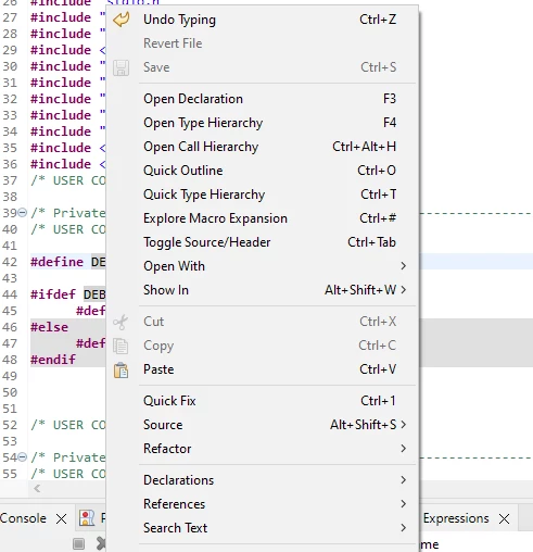

Do you get the shading correctly?
What happens if you do a 'Go to definition' on DEBUG ?
LPetr.1
LPetr.1Author
Senior
May 25, 2022
It wont let me go to definition. Clicking go to declaration doesnt go anywhere.0693W00000Nqe4sQAB.png

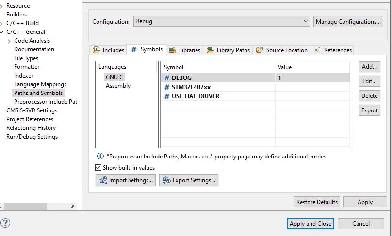

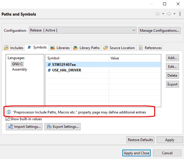

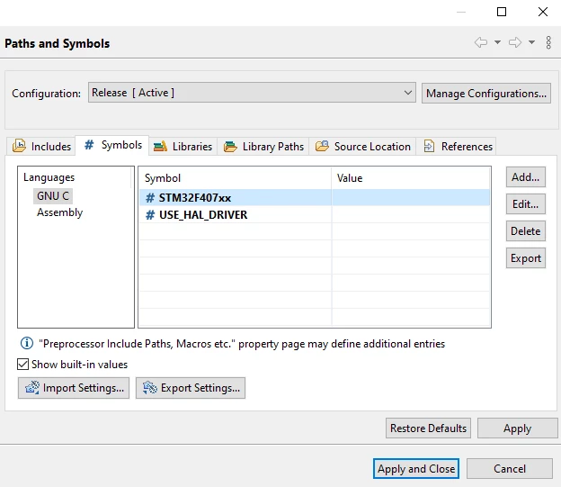

Do I need to add DEBUG symbol here?:
Andrew Neil
May 25, 2022
That's showing the 'Release' configuration - so you want DEBUG to not be defined.
Which seems correct.
Note that there are separate settings for C, C++, and Assembler.
It's common to define NDEBUG as a complement to DEBUG - so you might add that here.
NDEBUG and DEBUG should be mutually exclusive - you could check with
#if defined( DEBUG ) && defined( NDEBUG )
#error "Both DEBUG & NDEBUG are defined"
#endif

I cant find this property page

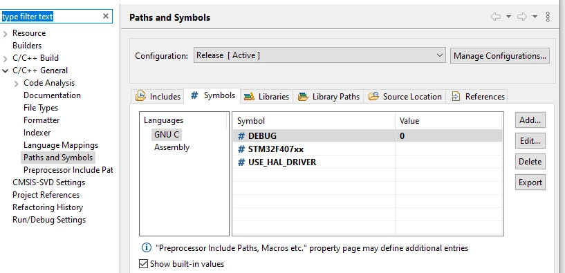

Ok I understand now. I did the following:
For release I define debug 0
For debug I define debug 1
Then in my main.c:
#if(DEBUG==1)
	 #define DEBUG_PRINT(X) printf X
#else
#endif
Now the DEBUG_PRINT only works when I am in debug mode exactly how I want to!
Thank you very much for your help
