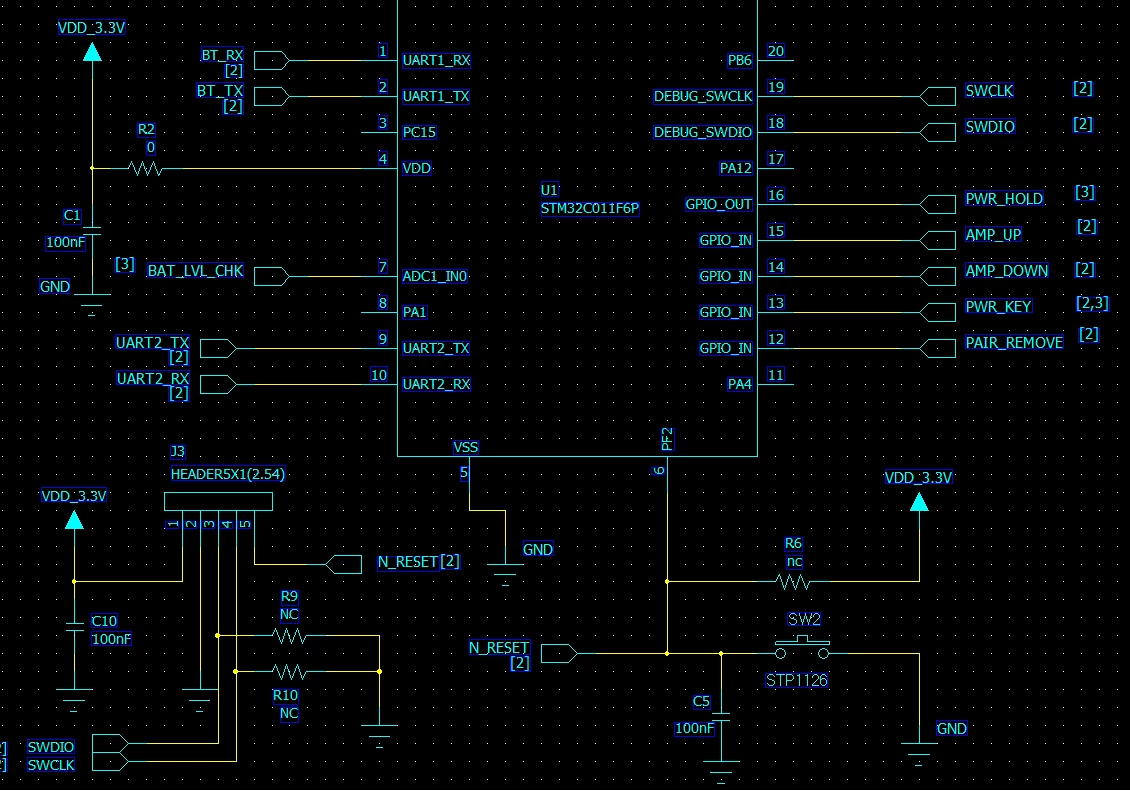

Hello sir,
I used stm32cubeide  with stlink v2.
I tried to download the *.elf file to stm32c011f6p6 chip however, I have the error

I need your help.  How to solve this problem?

    choi1Author
    June 23, 2023
    This is the schematic.
    Peter BENSCH
    June 25, 2023
    Can you please upload a photo of the ST-LINK/V2?
