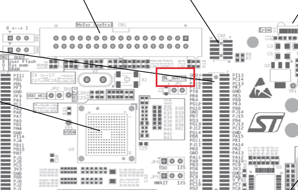

    No need to to but an ST-LINK as there is an embedded one on the board and you need to connect USB cable to CN21 connector.
    Sorry I meant these two switches. They need to be at position 0 as following:

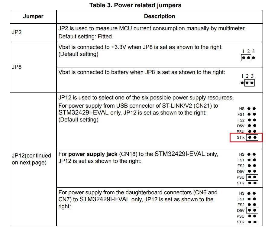

    Also How you did configure the power supply? i.e. what about JP12 position?
    You need to fit it at that position: "STlk":
    And no need to connect the other cables as they are not needed for just to launch a debug session/program the board.

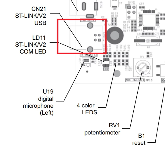

    How did you connect the board to the PC?
    This is the ST-LINK connector you need to connect to.
    No need for DFU mode (bootloader over USB) as you are using ST-LINK.

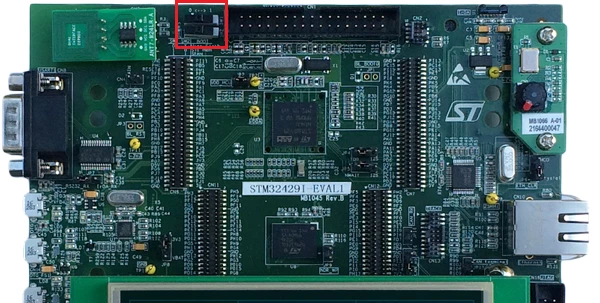

    What about Boot switch position? position 0?
    UnlimitAuthor
    June 27, 2024
    I did nothing to boot position as following picture:
    And I connected all of ports(ST-Link, PSU, and USART RS-232) to my PC.
