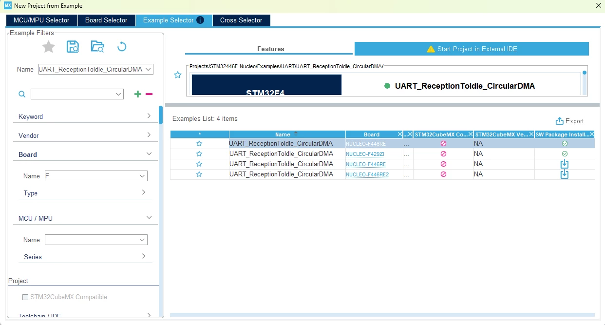

Hello ​@jonsmith67
You can take inspiration from the STM32CubeMX / STM32CubeIDE example projects provided by ST for UART communication with DMA. In the “New Project from Example” window, simply search for the following example names: UART_TwoBoards_ComDMA, UART_Hyperterminal_DMA, and UART_ReceptionToIdle_CircularDMA. These examples illustrate the main recommended approaches for UART reception, including basic DMA transfers, continuous reception, and DMA circular mode with IDLE line detection, which is especially useful for robust reception of variable-length frames. Even if the example is available for a different STM32 board, it can still serve as a very good reference for the HAL configuration, interrupt handling, DMA setup, and callback usage to adapt into your STM32F407 project.
You can also refer to ST’s official wiki page “Getting started with UART”, which provides a useful introduction to UART communication on STM32 and complements the example projects well: Getting started with UART
