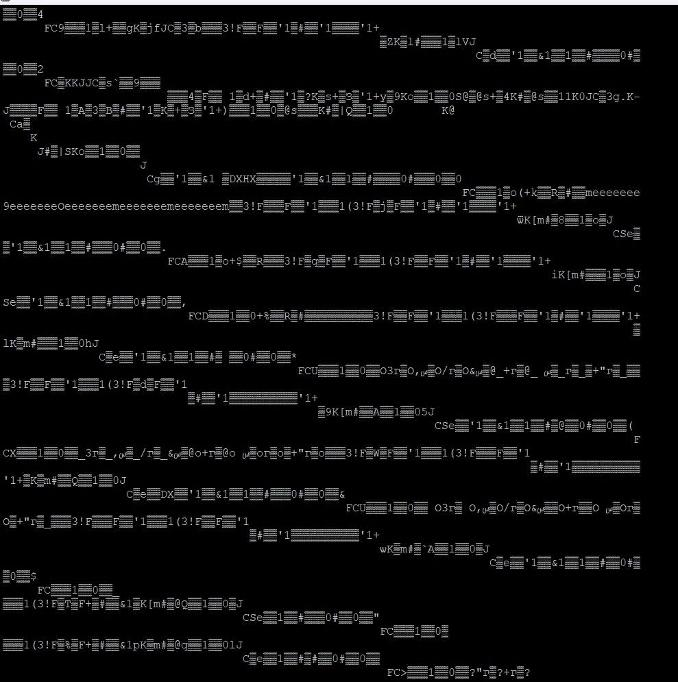

I would like to ask a question about STM32 OV2640 usage. My task is; take an output data from OV2640 and send to Computer via USART. When I communicate with UART, I took an output which shown in the figure. I did not is it true or wrong output but after output I'll try to convert data to image with python matplotlib library.

You start DMA, but then you need to wait until is completed before starting send via UART.
Try to send "hello world" first via serial, and then go further to the more difficult stuff.
And indeed check serial settings, especially the number of parity bits because cube includes parity bits in the total bit count, so you might need to select 9 bits and not 8 to obtain 8 databits.

Hello @koksoybedirhan ,
Which STM32 device are you using?
Could you please check the Baud Rate?
If you're just sending data over UART, you aren't going to see anything useful in the terminal. You would need to save that info and process it back into an image.
Do you have any issue after converting data to the image?
Thank you.

Hi @KDJEM.1 ,
Firstly thank you to reply my question.
I am using STM32H745 Nucleo Board and it has STM32H745ZIT6 microprocessor.
I tried 115200 and 9600 baud rate but I got same result for both of them.
For the sending data, I just saving DCMI datas to DMA and after I send datas to computer via HAL_UART_Transmit_DMA. I don't converting before sending data and I think that's what you say for the mistake.
Could you share links about converting DCMI data to image data in STM32?

Hi @Johi ,
Thank you for your advice. I think firstly I have to learn more about DMA usage as you said. Also I'll try 9 bits for serial settings.
