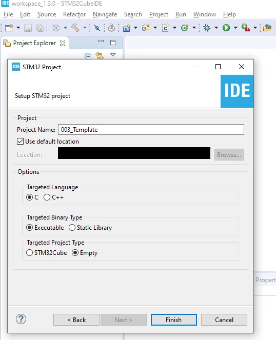

- How do I best create an empty project such that I afterwards include the pre-defined functions (peripherals such as ADC, Timers etc.)?

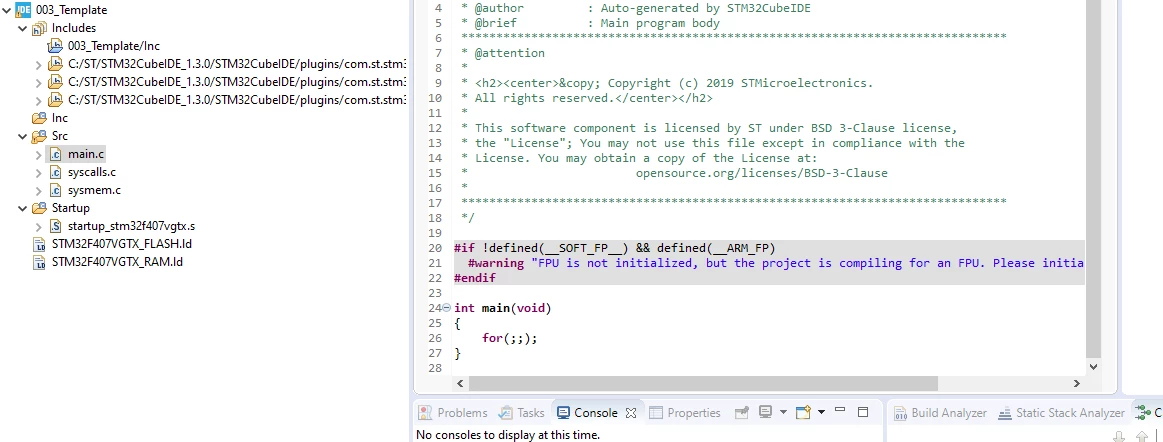

- My current approach has been: File->New->STM32 Project->Target Project Type: Empty (shown in figure CubeIDE)
- This seems to do the job (shown in CubeIDE1). But that brings me directly to question nr 2:

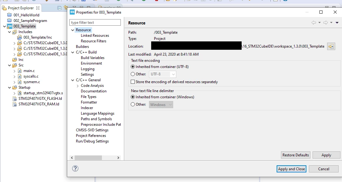

- Once I have this empty project, I would like to include the necessary pre-defined functions, header files etc. Where and how in the CubeIDE (project settings) do I do the proper linking and including (see CubeIDE2)?
- I have downloaded the STM32CubeF4 driver package and read the getting started manual. So now the question is how to include the necessary driver files into my project via STMCubeIDE.
