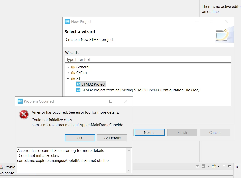

While creating STM32 project i am getting this below error
An error has occurred. See error log for more details.
Could not initialize class com.st.microxplorer.maingui.AppletMainFrameCubeIde
Can you help me out resolving this .

I am using the latest version "st-stm32cubeide_1.7.0_10852_20210715_0634_x86_64"

Did you just recently upgrade from an older version of CubeIDE to the 1.7.0 version using the P2 update feature (online update as opposed to downloading the full version of 1.7.0)?
Reason for asking is that my first guess is that something went wrong during installation/update and maybe all plug-ins were not installed correctly leading to that load of the plug-in in your screenshot fails?! Just a first guess...
Maybe you can paste the content of the following log:
Help > About > Installation Details > Configuration.
I am actually only interested in reviewing the list of under the headlines:
  • "*** Features:"
  • "*** Plug-in Registry:"
If you are in a hurry, you could just try to re-install the 1.7.0 version from scratch.
