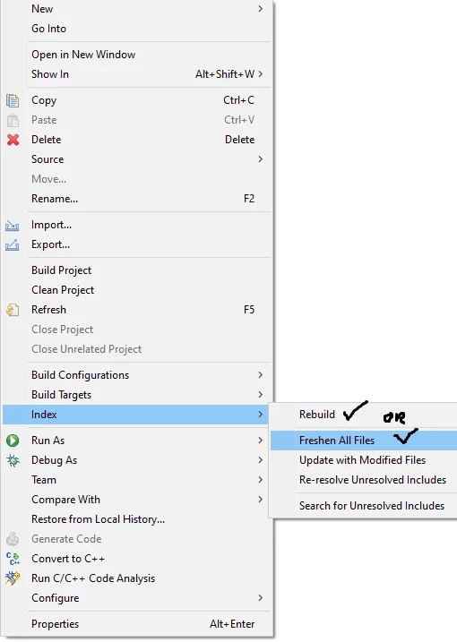

Hello.
Whenever I try to debug my file and use the live expressions tab, it used to work earlier and give me values but now it's just showing me failed to evaluate expression eve though I have correctly defined the variable. Please help with a fix. I recently updated my version to STM CUBE IDE 1.11.2
1 reply
Javier1
Principal
February 3, 2023
it happens to me sometimes, what usually works is to "refresh/rebuild the indexes" whatever that means:
