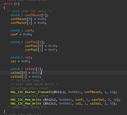

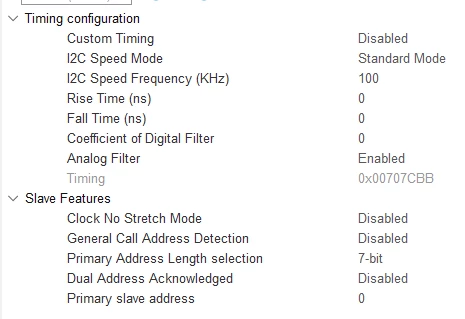

I am trying to get to use I2C on my stm32L4R5ZIT-P.
i am trying to configure a sensor by sending data but the I2C pins wont give a signal?
i dont ude interups or DMA
these are the pins that i use and the setting for I2C:
this are the includes i use
this is my code. i don't have any errors or warnings in the code
how do i fix it and make shure i can send data out?

    Does HAL_I2C_IsDeviceReady return HAL_OK? Do your other functions return HAL_OK?

    @fontys_student wrote:
     where can i see if the functions give a HAL_OK
    It will be the return value from the function call; eg,
    HAL_StatusTypeDef result; // for the return value from HAL function calls
    result = HAL_I2C_IsDeviceReady( &hi2c2, 0x40<<1, 10, 1000 );
    BTW: rather than writing `0x40<<1` as a Magic Number, it would be better style to give it a meaningful name; eg,
    #define SENSOR_I2C_ADDRESS (0x40<<1)
    then you can write:
    result = HAL_I2C_IsDeviceReady( &hi2c2, SENSOR_I2C_ADDRESS, 10, 1000 );
    Which is not only clearer & easier to understand, but also easier to maintain; eg, if you find that the address needs changing...

    What do you mean "won't give a signal"?  Are you looking at the SDA and SCL lines with a scope or logic analyzer?
    "I don't have any errors or warnings in the code" -> means no compiler errors or warning.  You need to check the return values from the HAL calls. Do you call MX_I2C2_Init() somewhere before the code you posted?
    Is this a custom board or one of the ST Nucleo (or Disco?) boards?  Are there external pull-up resistors on the SCL/SDA lines?  Using only the STM32's internal pull-ups MAY work for testing but should not be relied on in a production device - they are too high a resistance.
    Also, when posting code, please don't post images, copy/paste the code into the forum message using the code tags (click on the "..." button then "</>").

    Start with blocking functions. Call HAL_I2C_IsDeviceReady and ensure it returns HAL_OK before calling any other I2C function. Don't call HAL_I2C_EnableListen_IT at the start.
